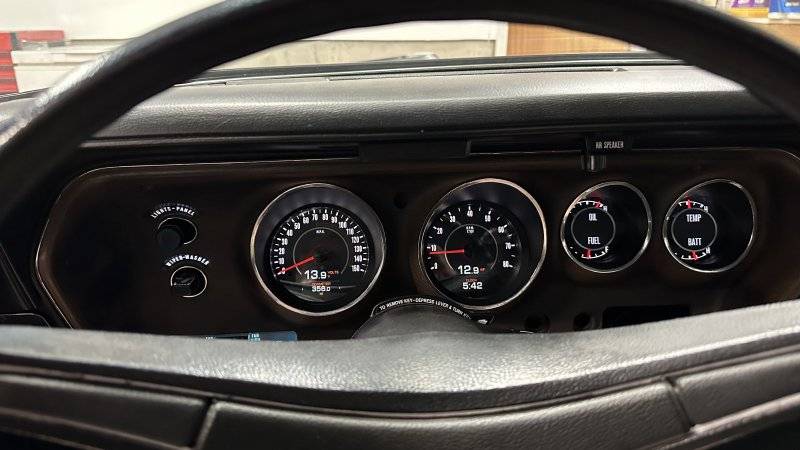

I believe he is talking about going from a factory standard cluster to an aftermarket “Rallye Style with round gauges” cluster. I’ve done it for another, not my taste. Fairly easy to do with either factory dash harness, similar to what YY1 describes for the factory standard to factory Rallye cluster. The aftermarket cluster bezel and switch mounting is pretty flimsy, needs some added support and no radio mounting in the bezel.

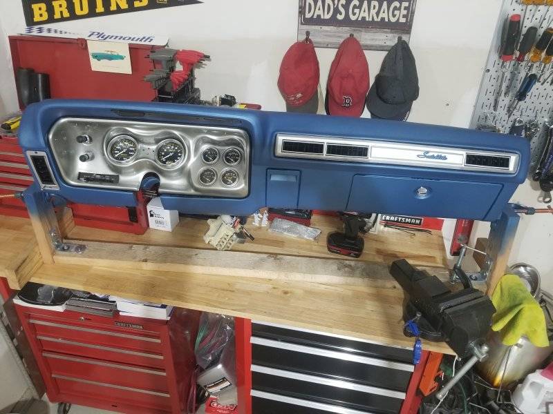

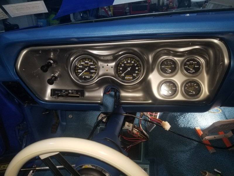

I installed that exact bezel in my 72 satellite. I went with the "Carbon Fiber" gauge set. The only complaint I have is the fitment for the HVAC unit. I actually tried to modify the opening for the HVAC unit, it didn't go well I was really pissed and contacted them about it (I have a thread in here detailing my experience). They sent me a new one for $99.00. I didn't attempt to modify the 2nd one. I'll send pics for reference. I had my whole dash out, which made it not too bad overall.
Rob
The problem with the Classic Dash bezel is the lack of frame to install the factory parts, like mentioned, switches and HVAC control unit, designed to fit to the frame and not to the bezel.
Next issue, lack of pilot/indicator lights… turnings, brake and high beams. No place for them since aftermarket gauges doesn’t have these into their fascia’s. Need to figure it out if not using the indicator lights gauge option from Autometer or some other manufacturer. Other wise will need to drill the bezel to install individual lights around.
There is also a nice insert strip with these indicator lights on market, but it won’t work for this bezel
View attachment 1768989View attachment 1768990
Rob

Thanks and Sorry for the late reply. I did buy a seperate wiring kit for the gauges. I believe it was associated with and/or recommended as an option for these gauges. I'll go back through my order history on Classic Industries to get a better recollection. BTW, I do appreciate that company and their website making it easier to go back and look at what you bought and when, especially the older you get.
