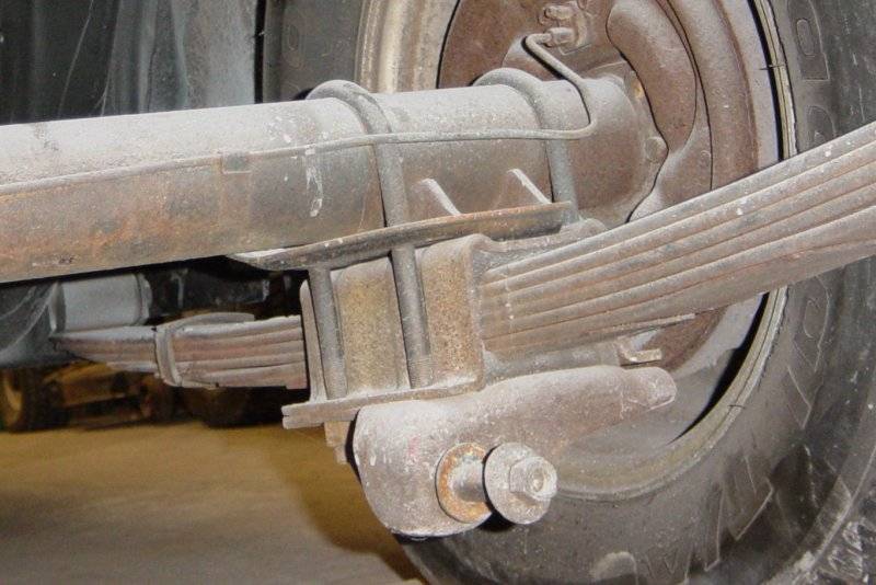

You may want to eliminate the iso-clamp setup on the rear-end too.
what does this entail and what is the benifit?
The iso clamps make for a sloppier ride. Getting rid of that setup will firm up the rear end a bit.
You can source the leaf springs and lower shock mounts from a pre-1973 B body. The non-iso shock mounts will have a smaller hole for the leaf spring stud than the 73 and up does. 73/74 spring retaining studs are 3/8” with a hat shaped bushing to accommodate the isolation pad while 71/72 are 5/16” studs.
