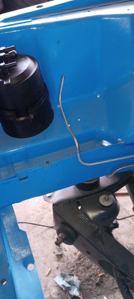

A previous owner of my 73 RR clipped the vapor return line at rubber connector between the front and rear sections and removed everything in front of that. I found a vapor canister/mount and ordered new lines from SS tube. Looking at the shape I believe I am trying to route the vapor return line correctly but I am stumped by:
What type of retainers hold the vapor return line to the inner fender - maybe the same clips that hold the brake lines?
The 5/16 line is smaller than the inlet on the vapor canister - is there a special line to connect them?
Any pictures of that area under the hood would be appreciated.
