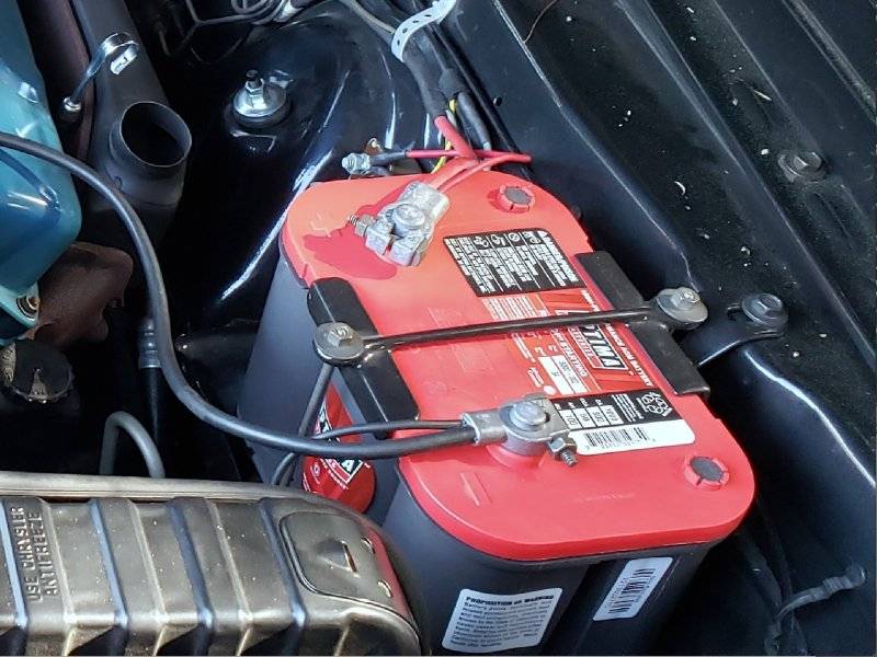

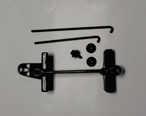

I have a battery hold down bracket as pictured, but miss a fender hole to bolt the fender bolt in? The hole in the fender is square, so I might have the wrong bracket then? Probably I need a U bolt?
A photo of the correct bracket and set up is very appreciated.

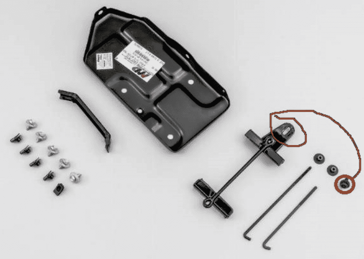

Thanks for your message, but I am referring the red circled bolt and hole in the braked so it can be bolted onto the fender? Not?
Yeap… along wity the inner J bolt attached also to an inner fender provision, the 71/73 is the one ilustratted with the built in bracket extension to be bolted to the top of inner fender.
74s however should get a separated bracket for that same function. Earlier assemblies works the same on 74s thought.
sorry, I don’t think I have a pic to ilustrate this at this moment, but pretty sure sooner or later will get a pic to show you

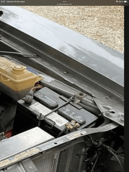

Got a pic…
its a separated bracket, which allows to keep the inner fender bolt in place while removing the hold down bracket. So don’t need to remove the bolt along with the two J studs nuts to get free the battery, just the J studs nuts
This divorced bracket of course remains in place while removing/servicing the batt
Got a pic…
Ok! So just a small bracket. I assume the bolt bolts into the fender with a U-nut, because the hole in the fender is square?
So, I have the wrong battery hold down bracket then.
The only difference will be the ”wing“ extension for the fender provision. i got the same replacement hold down kit for my 74 untill I found the correct divorced bracket, then cut that wing and done.
The divorced bracket is not available as repro, but actually could be somehow “home made”.
