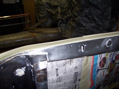

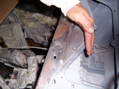

LAST 6 DIGITS OF VIN ON TOP OF FIREWALL DRIVERS SIDE
LAST 6 DIGITS OF VIN ON TOP RADIATOR SUPPORT CROSS MEMBER
Thanks hanks73340, found them exactly where you showed, but they were very very thin. Had to get the exact light to see them.
