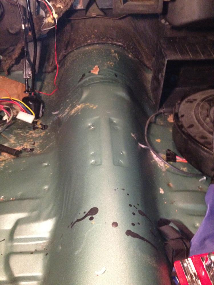

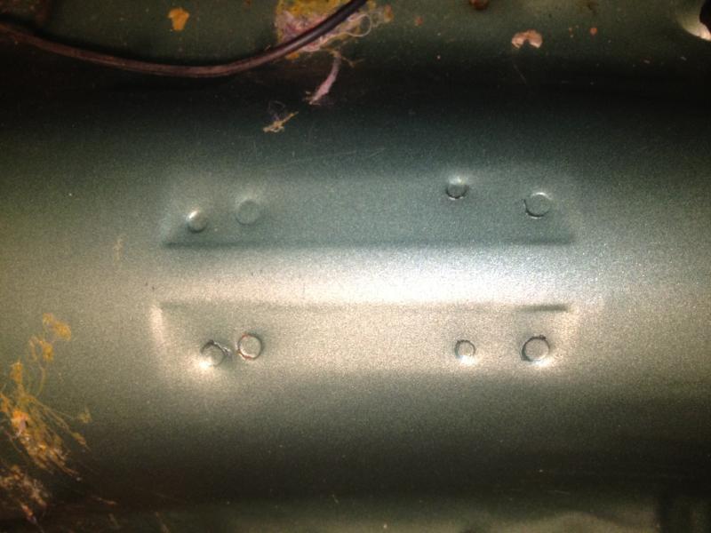

It's great to see some fellow BC Mopar fans on here! So it appears that the 75 Coronet had an option for a center console. I'm guessing that not many (if any) reproduction parts are made for late model B Bodies. Most of what I see runs up to 74. Does anyone know which consoles would fit into the factory location on this specific car? As I'm wanting a modern feeling interior, I've thought about the possibility of having a custom dash\console fabricated, but that's a lot of money so for now I'm looking at other options. I assume there are no places that offer interior trim for these cars either? Seems like I will be doing a lot of scavenging for this project.

A 1975 road runner would have the same floor pan. I don't think you'd have much difficulty in swapping in the '74 style either.
