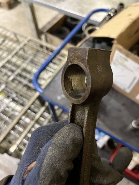

After trying to seperate the pistons from the rods i discovered one rod was broken. the piston connected to this rod was missing a piston ring and looked quite burnt. This was a small setback, but luckily i found a guy who has been building quite a few Mopar engines in Norway and he had one spare rod and is going to balance the whole rotating assembly for me. Hopefully i will get this done by next week.

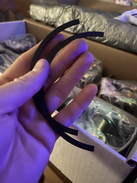

Then disaster struck again when trying to assemble new piston rings to the new pistons and one ring snapped in two. Luckily again the Mopar builder had one spare set of rings and could give that to me.
