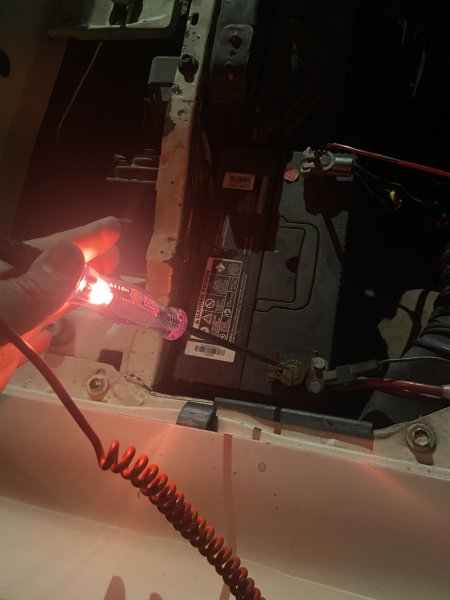

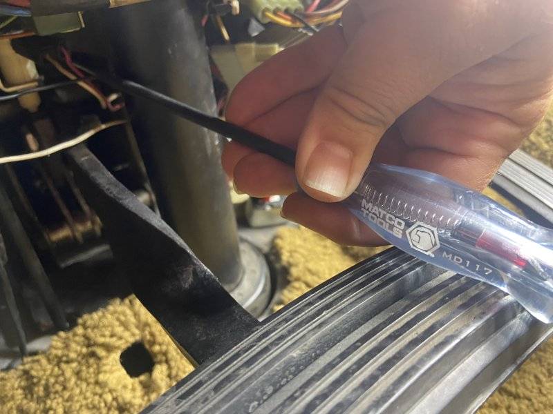

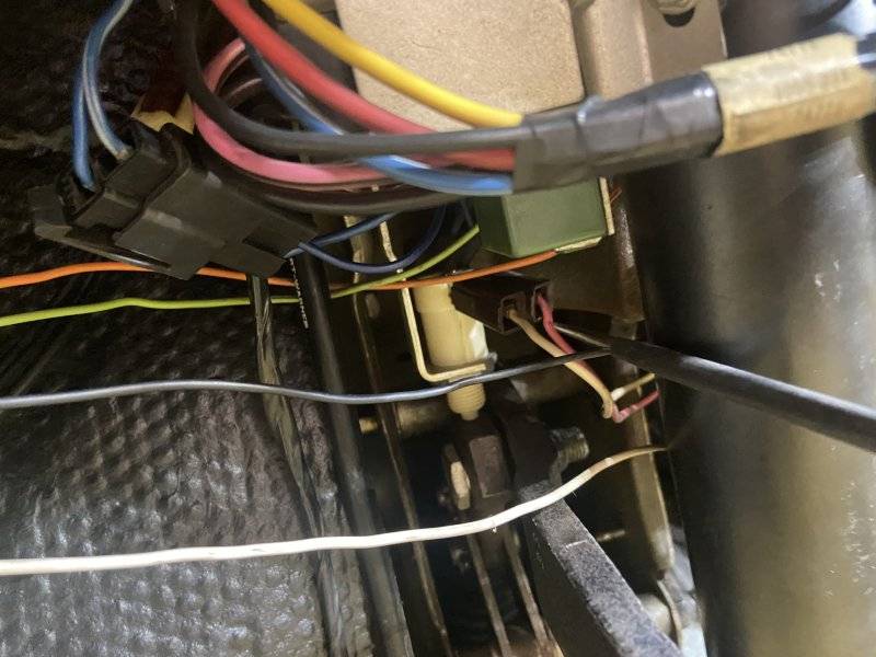

Test light. Connected. Working. Punctured pink wire. No light. Key off and out (Pretty sure that doesn’t matter). Next step please. Thank you.
Now go to the fuse box with your test light and verify power is present at both ends of the “Brake” fuse. Never mind the blue wires at brake light switch, they are for the cruise control cancel.

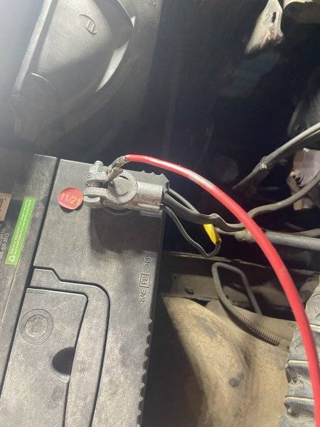

I was using the test light as a known good ground. I'll check if anything else is inop. The 4 way flashers do work. My son has been working a lot as well as I have. I will have more info hopefully tonight.

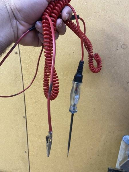

You can still use a test light. Make sure you have a good ground on the clamping end and use the needle probe tip and check both ends of each fuse. Also recheck that pink wire at the brake light switch.
