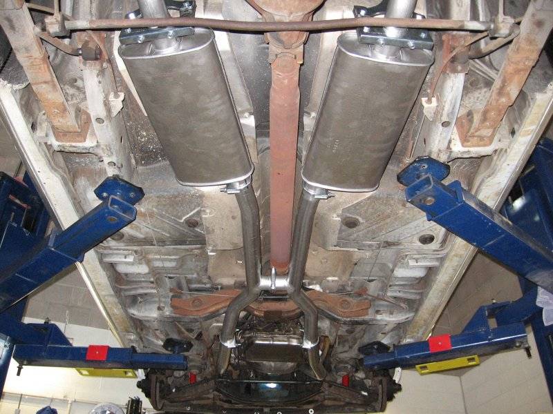

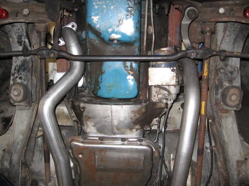

Late to the show but I have photos of when we did a 79 300.No headers TTI system.
