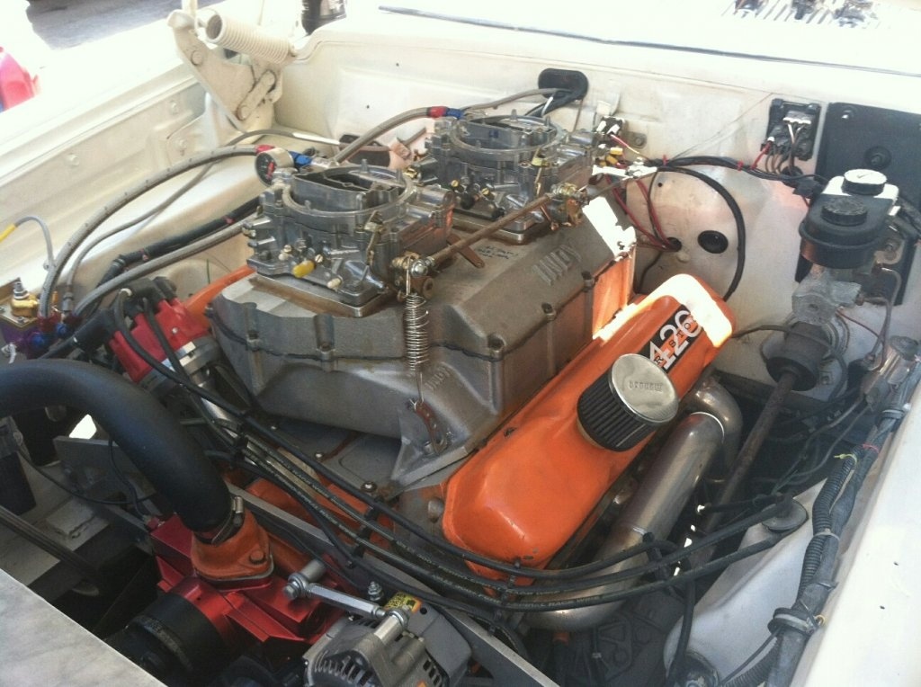

These are my TTI headers in my 63. Tight as **** in there to fit the mini starter.
Are your headers similar to these?

Yeah ss..that looks like them

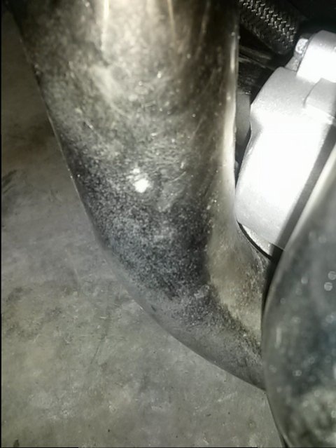

Here's a picture I got probably not that great
