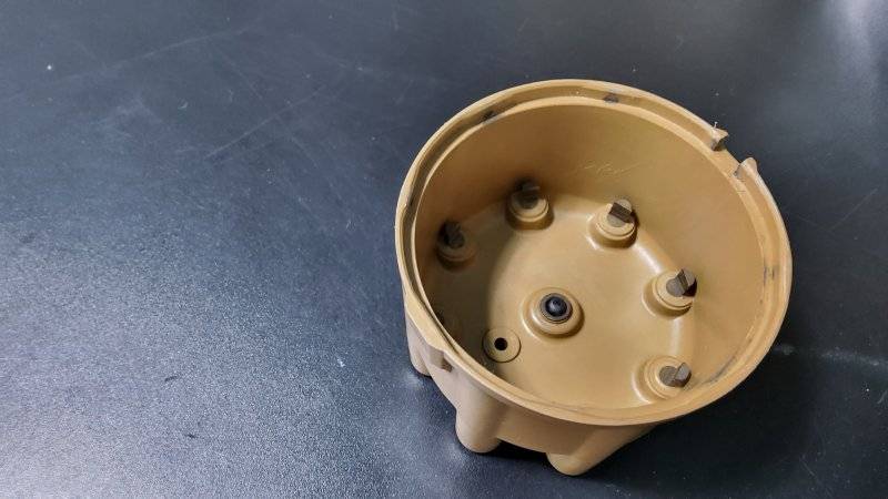

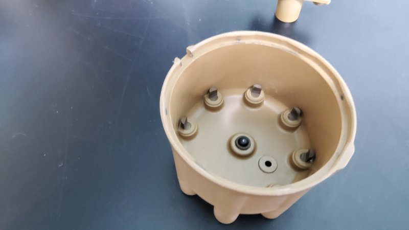

I don't like the carbon spots on the cap is that normal
