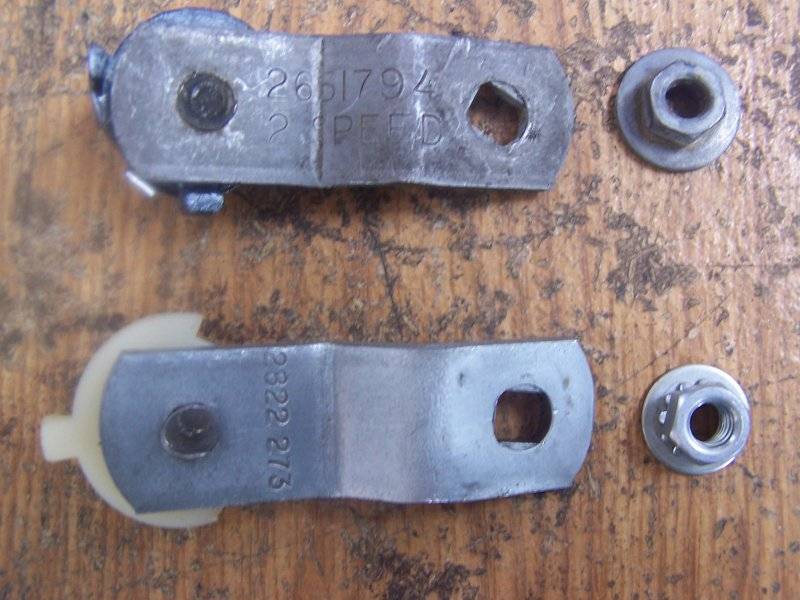

Hi everybody:
Is there any difference between a 2 speed and 3 speed wiper motor arm in a 68 Coronet?
Yes, and good luck finding the linkage that holds them together. You might have to fabricate that piece. It was 10 years ago when I changed the 2 speed to a 3 speed in my 68, I can’t remember all the details because I am getting older and have CRS syndrome, but I do remember they weren’t the same and the parts were hard to come by and one part in particular I couldn’t find so they never worked. I only changed to a 3 speed because I installed the Ramcharger Air Grabber and it doesn’t fit with a 2 speed motor.
Thanks for the awesome news LOL...I have a friend who may have one he can send me

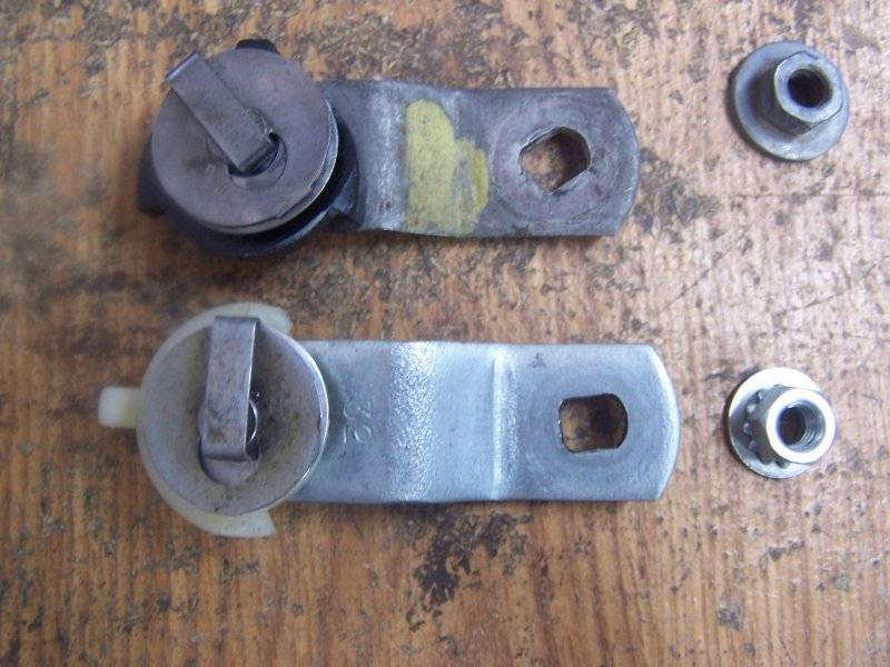

Here is a pic of the difference. They are clocked different and the bushings are different as well. Not sure which you need but I think I still have the 2 speed one
Yes. it is a bit shorter. It is the upper one with the black bushing in the pic . PN 2631794
I just checked. I still have the 2 speed arm along with both interface arms but no pivots.
