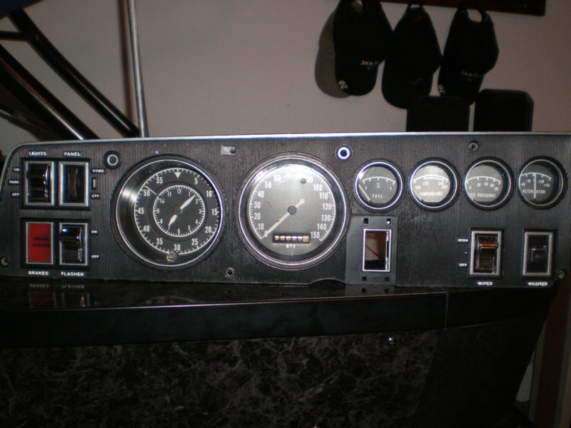

This is a picture of the dash before I took out the 3 speed switch. It has not been tested but should work as all of the others have except the dimmer which is in need of cleaning.

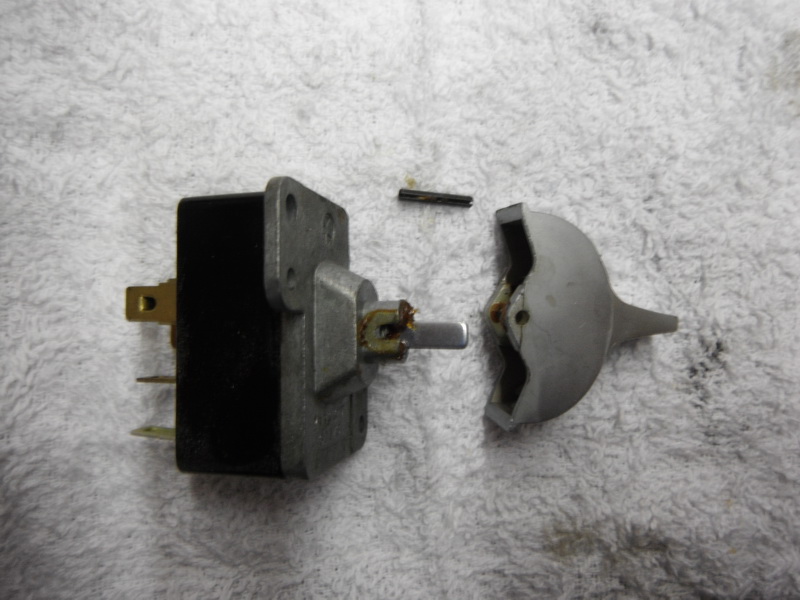

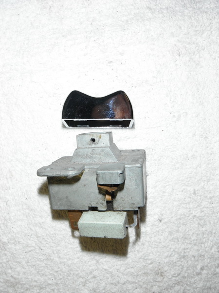

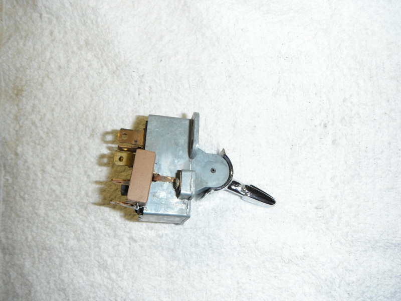

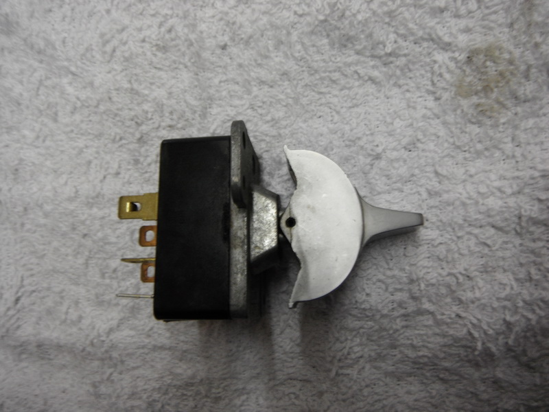

Difference In Switches
I finally Got Some pics together to show you the diff in the dicast cases.
If you download the pics the are named what they are.....hope it helps.
