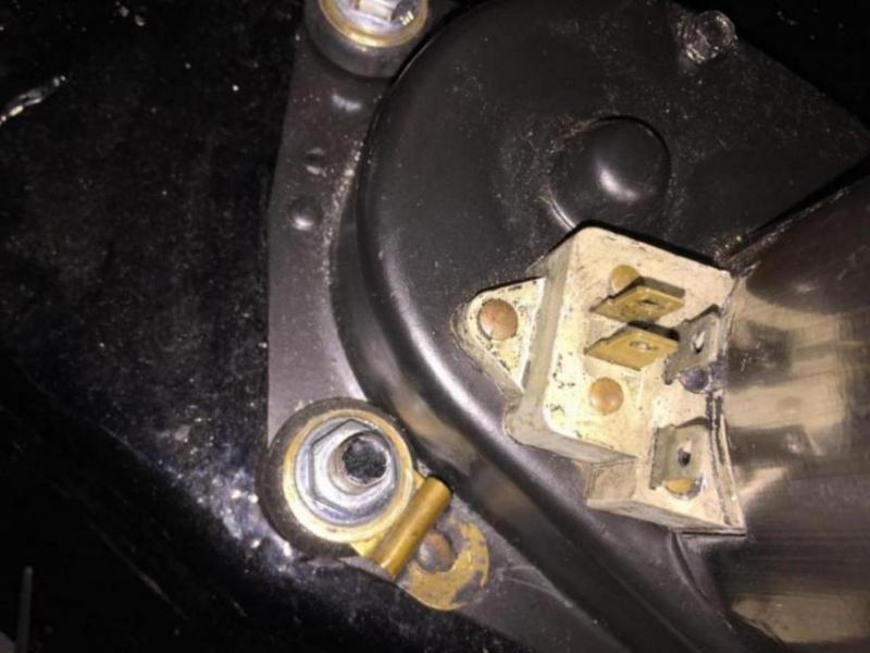

Sorry mate missed your reply. Thanks heaps for that. I gave it a test tonight and got nothing.
I did notice that my ground strap is in a different spot from the diagram on your website. I assume that's the same operation though?
The only time I got a noise out of the motor was when I applied ground and power to H and L. But still no movement. I tried grounding on the bolts, ground strap and body with no luck.
Any hints on what might be going on?
