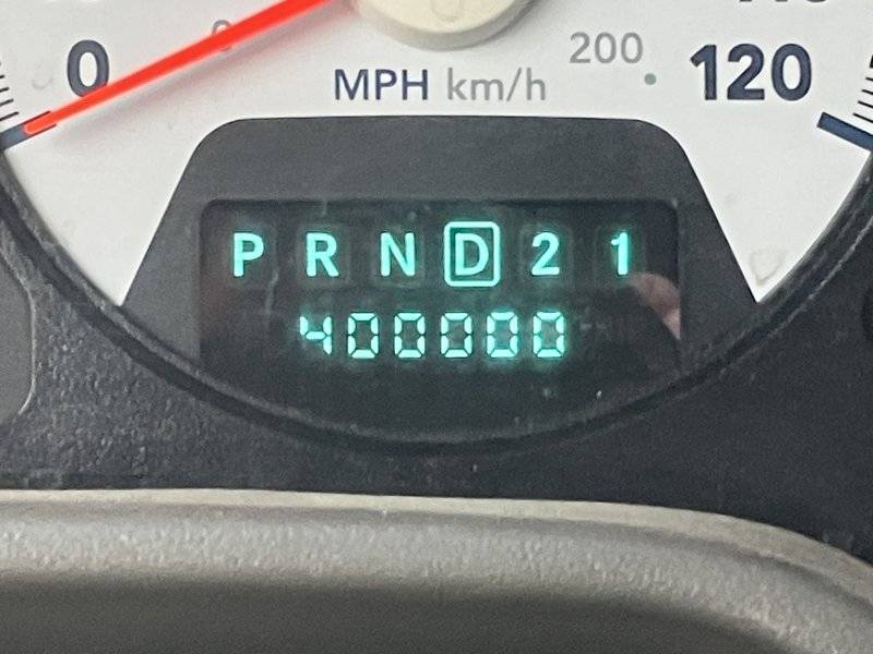

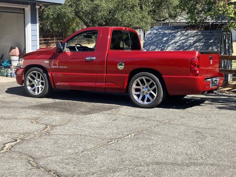

I have 407,000 on this truck, the picture was taken in January this year....
At around 59,000 miles, one or two of the MDS lifters crapped out, requiring replacement. Since then, the truck has been a jewel. I suggest to keep it stock.
