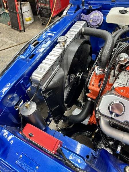

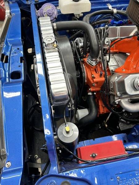

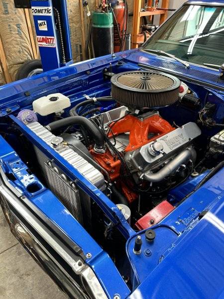

Bolt it in, I reused my driver side holes. I didn’t cut the opening.
View attachment 1702306View attachment 1702307View attachment 1702308
