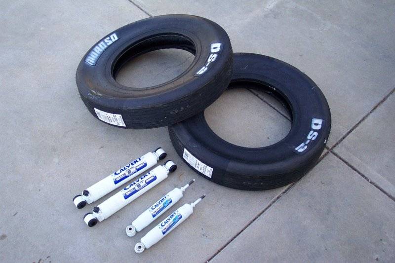

Second question:
I personally think that the 29.5" tall front tire helps a racer NOT to red light because it takes somewhere around .050 seconds MORE for the red light beam to connect.
Thoughts on this ??
Taller tire will also post a slightly quicker ET because the car gets a run at the starting line thanks to having more tool out. But in a bracket race it really wouldn’t matter
