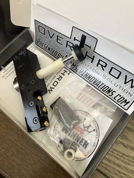

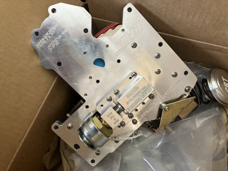

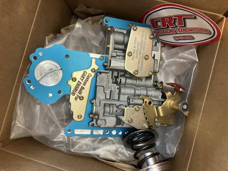

To address the 2nd concern, I’ve invested in a transbrake valvebody from John Cope, and a Cramsey Innovations Overthrow brake button. I’ve been fairly successful riding the 1967 Plymouth brake pedal at the floor of the car. But hopefully I can dial in a consistent routine and realize some improvement with this setup that can translate to a measurable difference in the results I’ve been seeing.
Just sharing…, Feel free to chime in with comments, questions, or suggestions.

I’m Thinking that the button will be mounted to the dash on a “stand-off” mount to the right of the steering wheel, at approx. the same depth as the wheel. This button I’ve got offers as much as .060 delay. There will be a learning curve I’m sure, but I’ve got to believe that one can be more consistent and more accurate using the dexterity of their fingers over the muscles in their legs.

get a quality button too
not some cheap hardware store momentary button

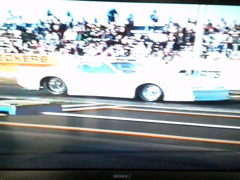

87 TransAm N2O T/S car
1988 Govn. Cup & Night of Fire Sac-Raceway my 85 TA 7.90 car #2 starting line.JPG

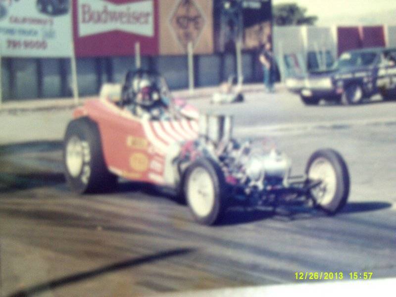

23 T Altered 8.90 Super Comp

It’s already got a bolt in sprag, 4.2:1 band lever, & a deep aluminum pan. I’m adding a billet L/R servo with the brake. The one thing I do still need to add is a billet front drum. The new valve body is a low-band apply design, as was the current T/A unit. I also run an SFI safety blanket.
I had a good conversation with John Cope about the drum. He strongly recommends it, but says that the brake itself doesn’t necessarily add any more danger than there is currently. Planning to add a billet drum next refresh.
