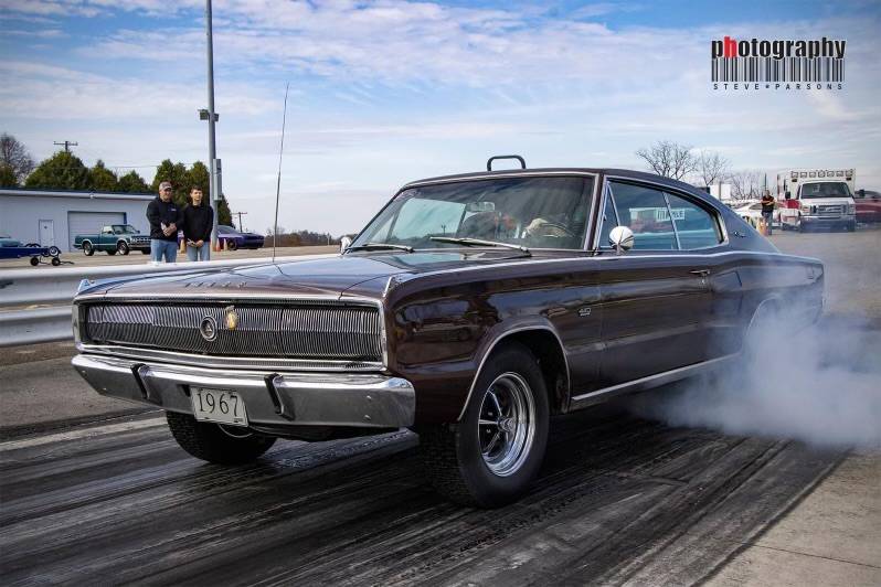

Back to the track yesterday. In short, it was all over the map. Weather/atmospheric conditions almost as good as last week. First run looked like last week - 11.30 @ 121.
Second run, I thought it bogged a little. Lost a tenth in the 60’ and ran an 11.45. I later learned, it was tire slip.
So thinking bog, I amp up the primary pump squiter cam and nozzle size. I put on a real good burn out. The car came out initially very hard, then the tires got loose, it got a little squirrelly, and the rpm got high enough that it shifted automatically into second (I race it in “D”). Had a 1.93 60’ and 11.8 et.
Not sure what I learned. Both tire spin events were in the right lane. Good run in the left. Maybe I’m just pushing harder on the converter. Maybe I’m overheating the tire. Maybe it liked the extra squirter. Maybe some combination of them all.
Here is a pic that Keystone has on their Facebook page.

If your running a street tire, which I thought you had a 255 BFG?..I think your experiencing track prep differences between lanes and weekends. Their is a huge difference in traction from a race oriented around street cars and a track prepped for bracket racing.
Love the picture.. beautiful car !
The tires are MT 255 ET Street-R.
