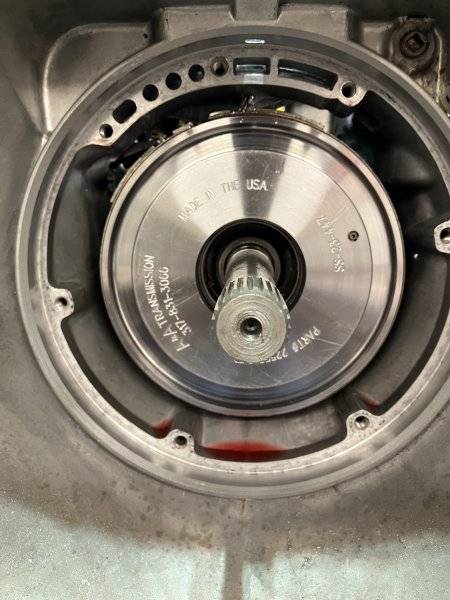

Endplay looks about right at .037 at the input shaft. Planning to tackle the valvebody today. Hopefully we’ll have this thing ready for install real soon.
Thought I had run into a snag when I air-checked the assembly and thought I was getting a leak. I had been told that an exhaust hole drilled in the front drum would essentially be a leak. But I just wasn’t willing to trust it. Pulled it all back apart and air-checked it again with just the drum assemblies and pump. Sure enough…. The clutch packs were applying, and the leaking air was coming out of the hole drilled in the face of the front drum.

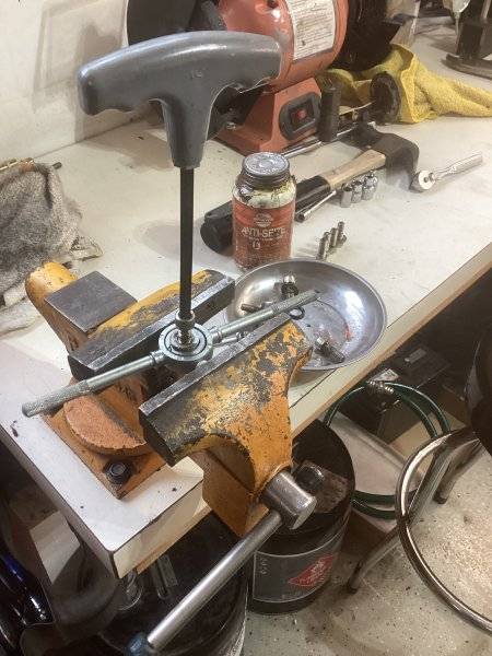

Re-assembled and turned my attention to the valvebody and bottom side. Everything went together without issue. I set both bands to 72”/lbs - 2 turns. Chased all the fastener threads, and buttoned it up. Hopefully I can find time next weekend to install it and road test it.

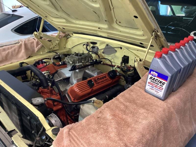

Install has been slowed by work and life…. But it is in and done. Now focused on getting the car on the ground, valve adjustment & oil change. Should be test driving it real soon.
Project complete! Got the car started today and took it around the block for a test drive. Initial response is that it feels very good. The new converter from A-1 appears to be noticeably looser at idle, yet feels somehow more connected. When you shift into gear, the feel is much more positive than previous. The timeslip will tell the real story, but A-1 did tell me they thought I could expect both a 1000 rpm higher stall speed, and tighter performance up top. I have hopes that they are correct.
