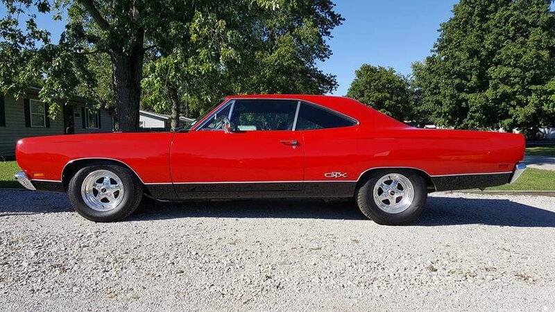

Not a typo. 275/60/15 on the rear and 225/70/15 on the front is a very popular combo. Easily gives you 1.5" of rake. Some even run 235/70/15's on the front. All depends on the look you are going for. I for one can't stand short tires on the front with a gap between the top of the tire and the bottom of the fender lip....
This is exactly what is on Fred (my GTX). Natural rake without too much stress on the front end.
Ok, i like your stance........but we can't get that size in the BFG tires in Australia...no idea why not....
