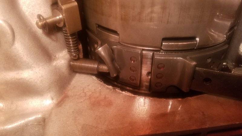

I was expecting the front frictions and kickdown band to be worn but they were in surprisingly good shape. The area where the front adjustment bolt pushes down on was cracked and folded over but I'm pretty sure that was from me torquing the band down before pulling the oil pump so I don't have parts spilling all over the place. The rear frictions were fine as well but the steels had scorch marks. I'm wondering if it's from an older rebuild and they never replaced em. Anyways now I'm dumbfounded as to why I would get slipping in 2nd. One reason why I went and bought a complete refurbished unit. The other reason was that I seized the rear servo piston while compressing it. I've hammered at it with a chisel and tried to get a slide hammer in there. Nothing. The bore is probably beat to sht by now. Oh well good learning experience.
Did you air check the front servo? Lets see a pic of the "cracked folded over part". I doubt if you hurt anything tightening it up with a 5/16" wrench.

After removing and reassembling everything else other than the rear servo the 904 is definitely one of the most elementary AT's out there. So mad at myself for screwing it up. I'm hoping they don't say something when I turn it in as a core.

Do you think it was the clamping pressure that wrecked it then? I have seen posts about people trashing these new riveted bands from their rebuild kit in favor for cast bands.
I've torqued that adjustment bolt to 72inLb before during my initial stages of troubleshooting and even though I didn't use a torque wrench this time I never got to that amount of resistance.

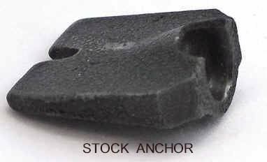

Where is the band anchor wedge? It fits between the adjustment screw and the band. In the pan? looks to me like it fell out and was then adjusted.
Doug
Doug
Humm, are you sure that's not for a 727 only? 904 bands usually come with a slight indentation to keep the bolt in place. Anywho that part wasn't in there at all. I took the entire thing apart. A ball bearing did fall out when I was tilting the case around but eventually I found out that belonged to the valve body gear selector.
I just watched a video and it looks like there is no anchor on the 904. There seems to be an issue with replacement stamped bands having insufficient dimple to keep the adjuster. A cast band sounds like a no brainer especially if you up the clamping force via shift kit.
My bad, I was thinking 727. I still believe the band was damaged causing the issue.
