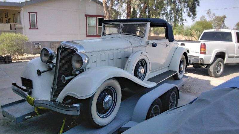

From this?
This was what I was thinking reading through the thread.
And to add; my ol 67 newyorker had the 350 horse 440.... with just one of those exhaust pipes..
Me too. Mine was a 67 Chrysler 300. Ran great.
