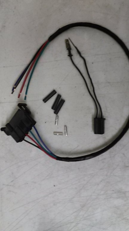

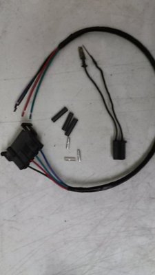

I can make you a harness and include the butt connectors and shrink wraps to attach to your wires coming out of your cylinder. I'd have to know the year of the car on the pigtail for reverse back up/neutral safety switch because 68/69 had black/black with white tracer wires and 70 had purple and solid black wires.
I was just going to contact you! This is a 68 Coronet 318 with AC. Actually after comparing wrong schematics I realized (been a while) that the 2 extra wires are to the AC and available from YearOne (ordered today) that I need to insert into the bulkhead connecter. So all I need is the bulk head connector to the motor (4 wires). The cam switch is NOT potted in red goop and has two spade terminals on it.
