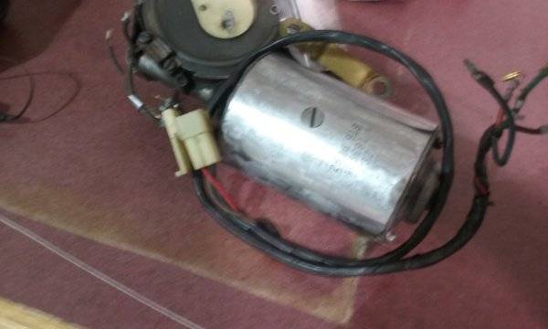

Just curious as to exactly what the difference is between b-body and c-body 3 speed wiper motors. The one on my 69 is bad and I have 2 from c-bodys just sitting here and was wondering what it would take to be able to use one of them rather than buying another from a b-body

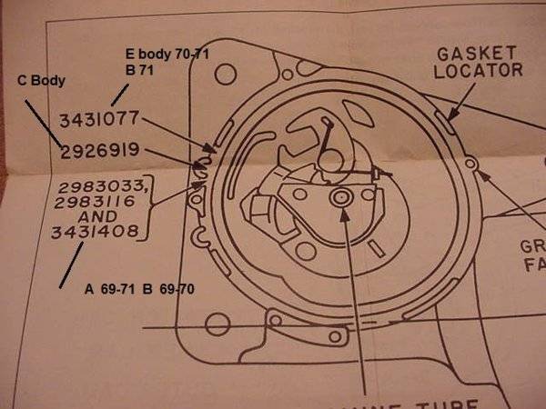

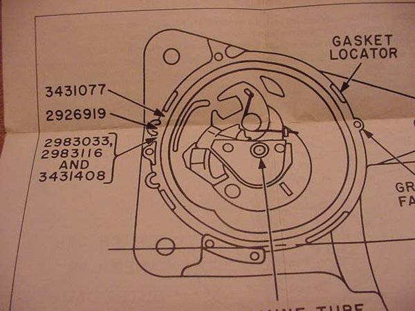

If there are any differences ... Possibly the clocking of the "park" mechanism. This is changed by rotating the cover plate. If you notice there is a small tab that can be rotated into one of two slots on the edge of the cover plate. The other difference is possibly the arm that bolts to the motor.
The motors are essentially the same. The difference is in the number found on the barrel. This number designates year body etc. You may find harness plugs different but the wires are the same.
