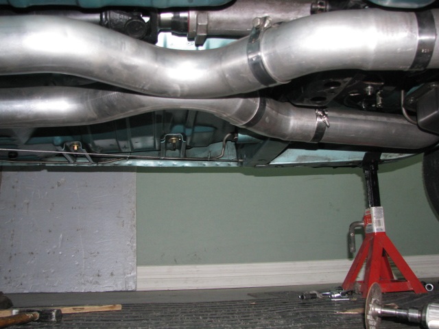

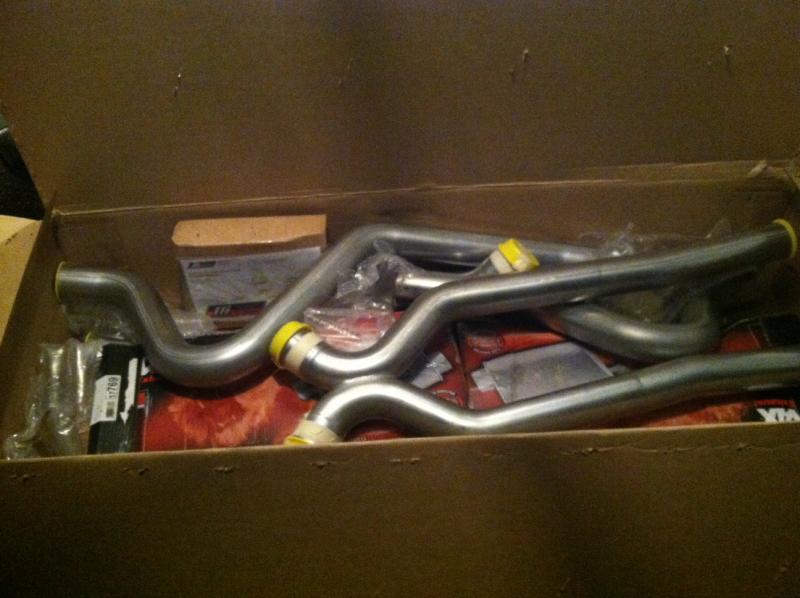

Has anyone on here used a 3" TTI X pipe from header back? My 21/4" existing tailpipes are rear tight between the tank and leaf springs as it is. The tailpipes have become rusted and it all needs changed. I have seen a couple cars with the tail pipes lower. Is that what I can expect?
Thanks for reading
Just installed a TTI 3" x-pipe exhaust system on my 67 GTX , it is not a bolt in system as everybody thinks . had to fit mid pipe to header collector adapters , then trim back of mid pipe to get the mufflers(dynomax super turbos) in place so tail pipes would sit correctly over the axle. as far as the tail pipes go it was tight. had to roll both rear seam corners of the gas tank a little. once you set them and weld the hangers they provide you should be ok .its a good system but you need to do some cutting and welding .i got it done with a little help from a good buddy of mine (a buick guro). two man job with jack stands. if you have access to a lift you don't have to get up and down and up and down and up and down from under the car a hundred times p.s. the system sound better them i expected. good luck TTI 2.jpg

I don't have mine all the way on but have test fit (removed, installed, removed) them a couple of times on my 66. I did have to bend part of the gas tank (the flange where the two halves of the tank are put together) stuck out to much and where easily bent towards the tank with a mallet.
I have had them for about 3 years. As mentioned, clearance is tight around the tank and axle. But they fit. I didn't have to cut mine. I know a lot of people like loud cars- I don't. The Dynomax mufflers are "medium loud" to my ear and I still wish mine was quieter. Although I've had plenty of comments that it's too quiet from others...
Sometimes TTI goes to shows and you can catch them and get free shipping (I did). Otherwise, yeah, it's a big heavy box (two or more, actually) and it's not cheap.
