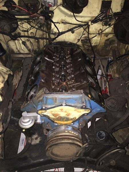

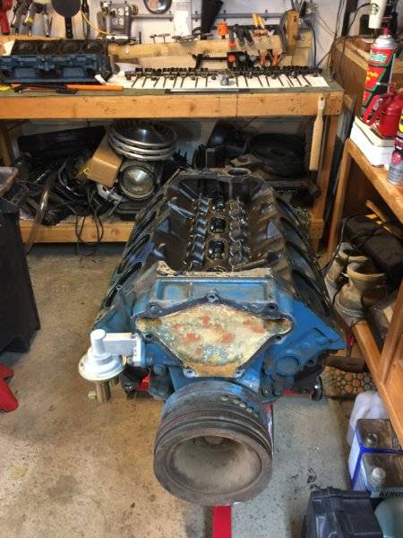

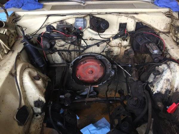

Shazam she’s out! Thank you all for that great advice and encouragement! Really paid of in making this dissassembly smoooooth! Especially want to thank dryheat who was able to lend an expert hand in plucking the engine!

Hey Sublime I am not sure yet. Dryheat took his scope and inspected the interior of the Edlebrock Performer manifold and we did not see anything to lead us to believe that this was the cause of the water ingress.
I have not yet inspected the engine as my back is still bugging me but now that the block is on the stand I will get to the inspection tomorrow hopefully. I doubt I will be able to find the smoking gun. I am still puzzled how I could have a leak on both sides of the block.
I can say the this engine looked ok before I started it up. The oil was not milky when I changed it as I prepared it fir start. Some thing happened quickly that caused this and the only thing I can think of was simultaneous head gasket failure. What are tge chances of that?
