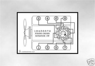

The position of #1 cyl on the dist cap can be any of the eight positions. You just need to make sure that the cyl that is firing has the plug lead going to that cyl.
To ensure that initial timing is set for a quick start: set timing mark on dampener to 20* [ yes 20, not less; can be adjusted later ] #1 cyl on compression stroke [ both valves closed, remove valve cover & check ]. Dist rotation is CW. Remove dist cap & rotor. The spark fires just as the trailing edge of the reluctor passes the pole piece. Rotate dist to get this position. Replace rotor; note which cap segment the rotor is pointing at. That is #1 cyl. Arrange plug lead positions accordingly.
