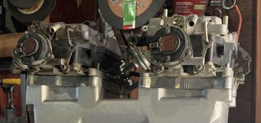

Here’s your electric choke! 2-800 TQ’s!
:rofl::rofl::rofl::rofl::rofl:

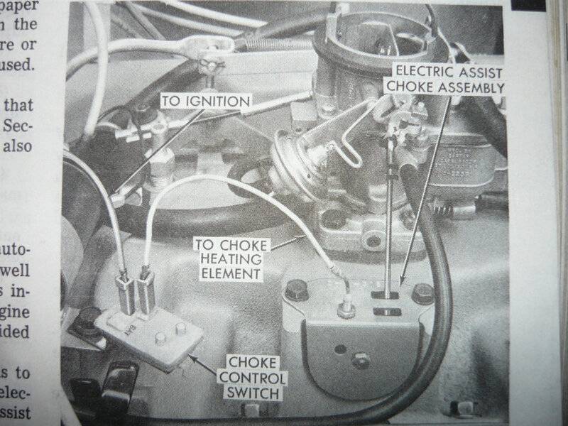

They sell an aftermarket electric choke for thermoquads. Or Get the biggest Street Demon 750 i believe.
