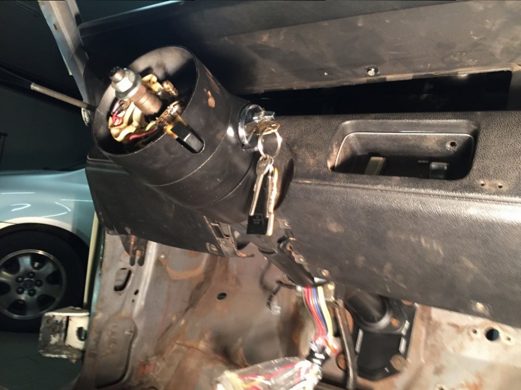

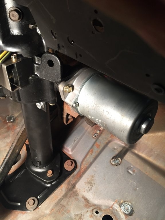

Pretty cool dickdale. What make, year and model did you do this to? Any other pics? What parts were used? How has this set up performed for you... are you satisfied? Any other details?
Thanx
Hi Dennis, I've used a 2005 Vauxhall Corsa power steering and a b-body floorshifter steering column.
Besides that I've bought a proximity sensor from rallywiz.com.
I've cut the steering shaft from the b body and put the ps in between. I've used the Vauxhall ps (from the U.K. RHD) because the ps motor is on the right side. I've also tried the Opel Corsa (LHD) but then you have to adjust a lot.
