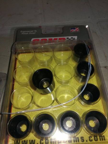

my comp cams kit came with Umbrella type valve seals. are they any good or should I go with positive type seals
The Comp seals are excelent. I use them all the time. They are not the PC Teflon style, but rubber. They do require guide machining. Stock seals work fine if you have valve spring/retainer clearance .
Doug
my guides were machined.
My exhaust is .3724 and my intake is .3716 looks like theyre good as the seals are for 3/8s
