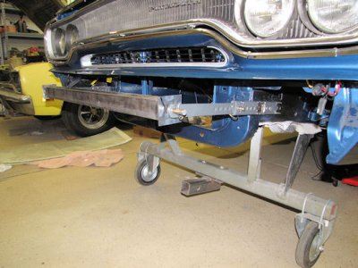

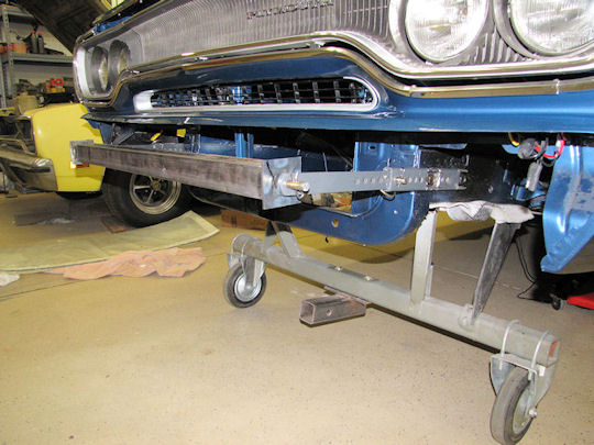

Yes! Block the K-Frame and trans on a furniture dolly/platform, and then take out the K-frame bolts (4places) and the four trans cross support bolts and nuts. Put the CherryPicker on the two front frame railsor bumper and lift the body off of the engene, just like in the factory. You won't scratch or dent anything, like the firewall, and the body comes right off! Of course, you do have to disconnect the torsion bars and the shocksand also the pitman arm, but this is much easier. The whole unit will not come out the top without re-balancing and alot of help from your friends. Good luck!

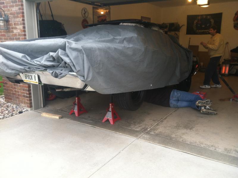

If you can and have 6 ton jackstands, jacked up the rear end as high as you can go and rest the rear axle on the jackstands. This will help pulling the motor and tranny out with the clearance to pull the tranny out.

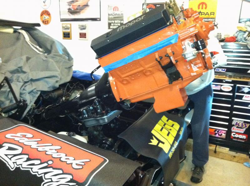

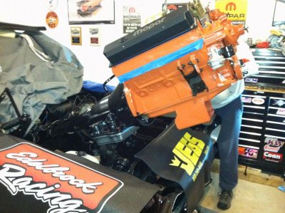

I've got to put a 440 and four speed in and I'm looking how to do that since I normally use four bolts somewhere on the block and four chains. But with the distributor in the front right area is sort hard to route the chain there and I would like to use a carb plate like I think he has in the picture.
Yep, that's Super Bee Bob!
Lee, looks like you had some help from 'Bumble Bee Bob'. :eek:ccasion14:
Shouldn't be an issue. People have been doing it this way forever. And my intake is the Edelbrock Six Pack aluminum intake and I still felt comfortable lifting it via the intake.

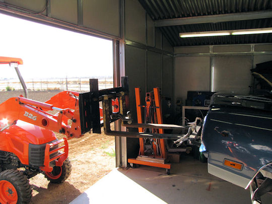

Borrow/fab dolly, then find a friend with a tractor/fork lift attachment...

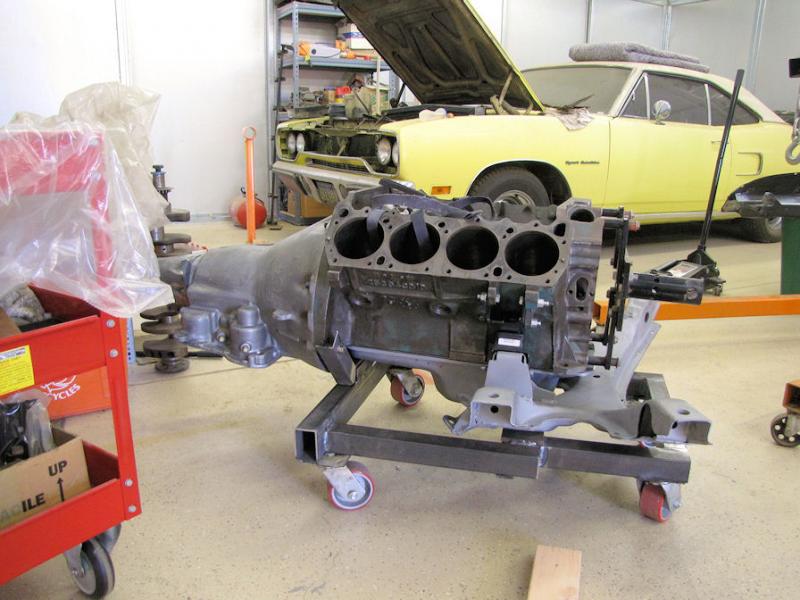

same here, first time needed help but 2nd and third I used mac's pivot plate to pull the entire drivetrain out from the top on my own. It makes it a lot easier to do the install. Dont worry about the intake, it can take the weight.

Using a 2 ton cherry picker & an adjustable load leveler the entire engine/trans. assembly lifted out with no trouble.
