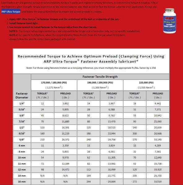

What's the difference in the torque?
40 ft/lbs but I usually set them lower never had an issue.
