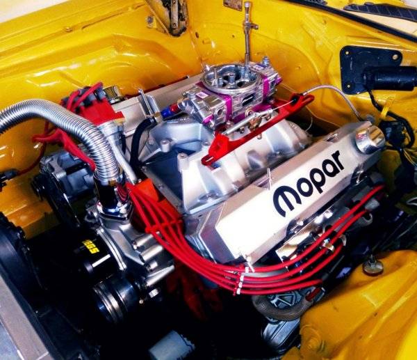

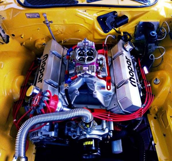

I need to replace my gear 3.73 what gear do you recommend ? 4.10 or 4.30
at this moment I use M / T drag slick 28x10.5
my engine is a
440 .030 over
0 deck 11.5 compression
edelbrock performer rpm heads
intake edelbrock performer rpm
carburetor proform race series 950
comp cams solid xe282s-10
DUR .050 244/252
LIFT .520 / .540
rocker arms full roller 1.6
transmission coan with transbrake low band
torque converter tci drag race 9" 4200
