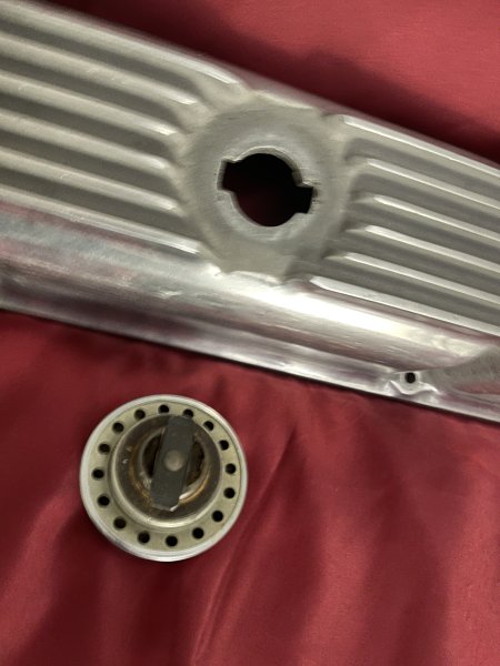

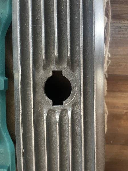

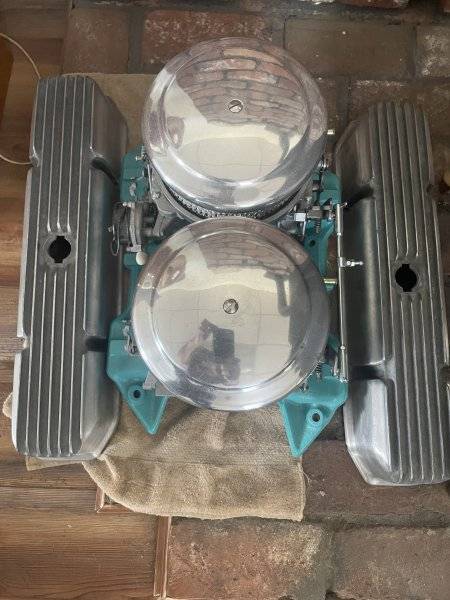

I have a set of Early 4 bolt big block moon brand valve covers. That I need a breather and PCV valve for.
The ones I have tried so far are too big around and interfere with the fins.
Any ideas what might fit?

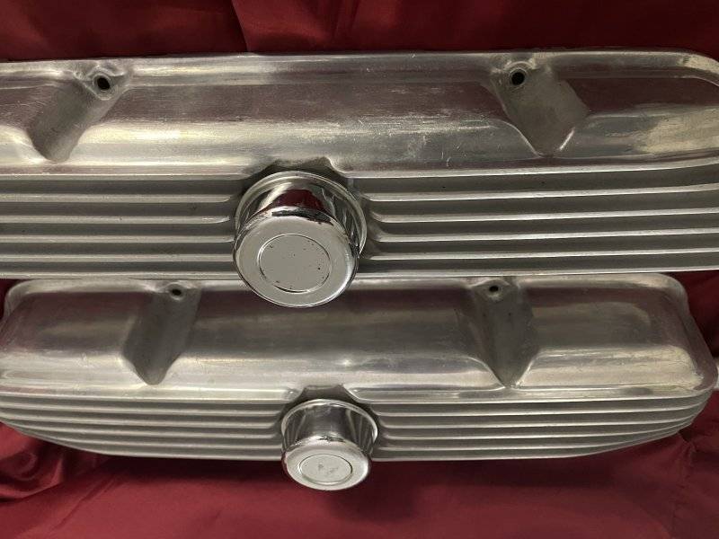

On the pcv side a grommet is what I used on my Mopar Performance finned covers.
Usually really thick but seal well.
Go on summit (or jegs, etc) site and search Trans-Dapt grommets. I found some, and some breathers similar to post #4 there for an odd situation like that once. You should be able to find grommets that fit a more modern (70's-80's) pcv valve too.
