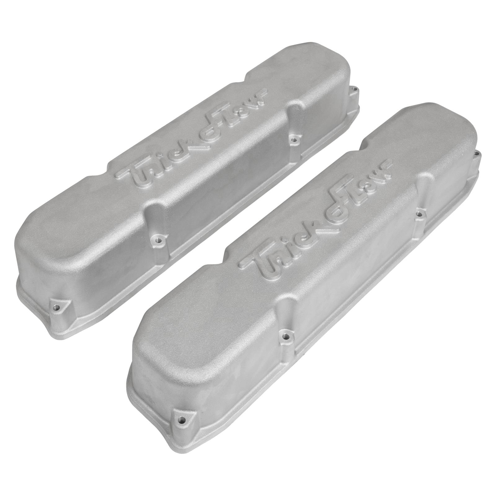

Trickflow Valve Covers​
Maybe it’s just the picture, but those don’t look very tall. If you’re committed to using them, a set of spacers can be added for additional clearance.

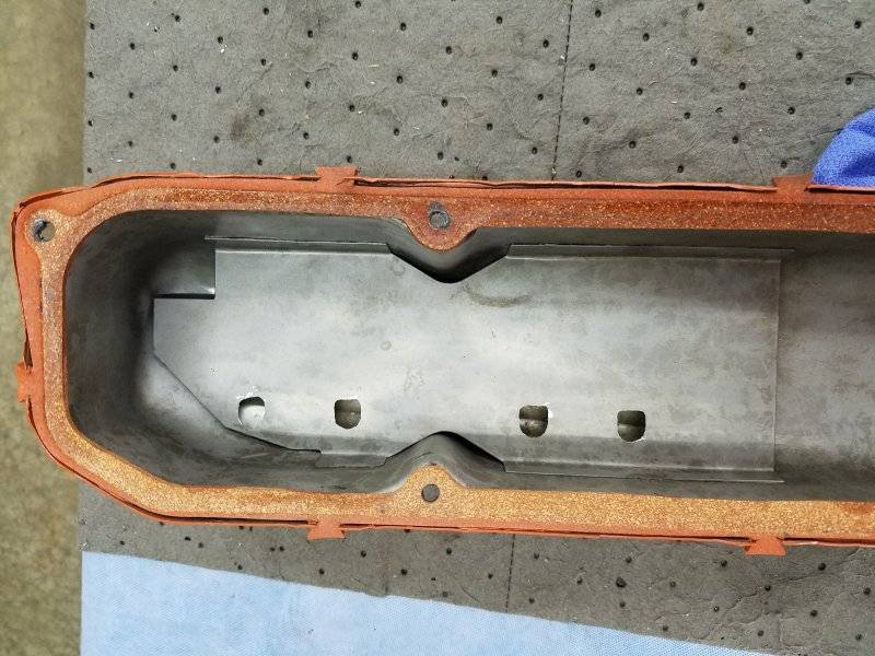

I have a 440/505 stroker with Trickflow 240 cylinder heads, hydraulic roller camshaft and Hughes roller rockers. I wanted to keep the stock look so I had to clearance the baffle in the valve covers and use a spacer. Otherwise they would hit.

If you see witness marks from the outer rockers maybe try a steel core gasket... those things are pretty thick.
