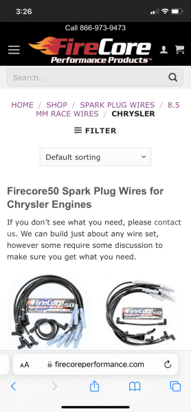

Firecore

Did you use 90 boots or straight for 5&7? I’m sure I will have to make my own set of wires.

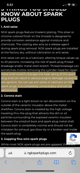

Did you put any antiseeze on the plug threads?
I always antisense. Especially on plugs going in aluminum heads
