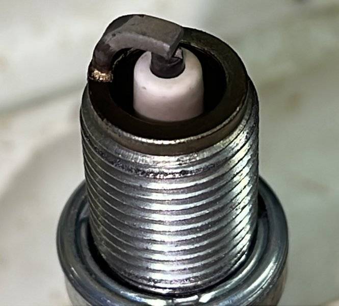

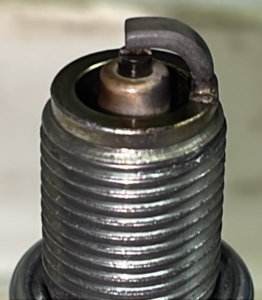

- I removed the plugs and noticed my #8 plug doesn't seem to be firing and the rest of the plugs look white with a patch of white? on top of the side electrode.
- I haven't done a compression check yet but the engine builder did have a note about 160 psi. This is not confirmed yet. I am doing that tomorrow.
I have never seen plugs this white before The center insulators are white but look like they are firing. The side electrodes look like they have bleached blots on top. The majority of the plugs appear white like this. Consistent. The motor has only run about 20 minutes? I drove it down a block or two and came back because I didn't have much fuel in the tank. The motor really didn't seem to have much response so a lean condition seems more and more an issue.
Since the cam and heads have I would think a lot more flow capacity I am thinking I have either a lean condition and have to jet the carbs out AND/OR in addition I have to try a colder plug. I could even try another plug besides the NKG plugs. I found my paperwork for the Trickflow heads and they list an Autolite 3924 plug.

Plug picture:
First plug below doesn't seem to be firing

A lot of those plugs looked like they got gas washed really bad
You sure you have your six pack figured out , especially that center carb
I am not a six pack expert , except when it comes to beer , however before you can start reading spark plugs you need to get that fuel issue figured out

In the first 2 pictures, the plugs haven't been tightened. The crush gaskets aren't crushed. Replace the 1 fouled plug and try it.
Yes that was a thought when I removed a few plugs they loosened easy.

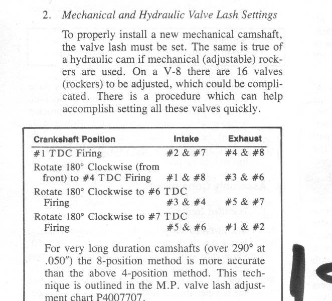

Did you check the valve preload adjustment. With the EOIC method.
I have not checked preload. That is also a concern. Please define/explain the EOIC method.
I have read posts and seen people use 1/4 turn to half turn to full turn after removing free play.

The EOIC takes forever & is not necessary. The chart below [ from Chrys ] uses two full turns of the crank to adj 16 valves.
Some lifters bleed down, some do not. Both are ok. As long as they pump up [ no noise ]when the engine is running. During adjustment, if you have a lifter that has bled down, it should feel 'springy'. That is the small spring inside the lifter. As long as there is no actual play/clearance, you are ok.

But now I have another problem that I hope isn't serious. I used the chart above and after restarting the engine heard some clapping noise that did eventually go away thinking it was again bad lifter preload.
I readjusted the preload using TDC for each cylinder and that lowered the noise. I was very careful to follow the chart.
