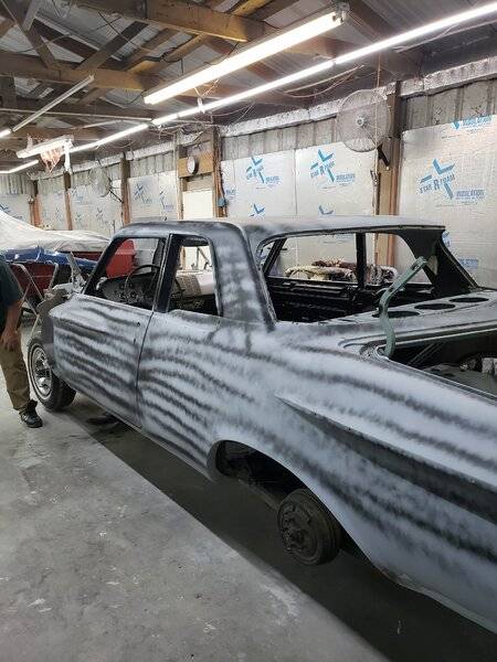

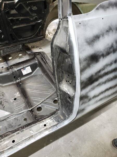

Most guys take the doors and the rear post for the door out of a 2 door sedan and put it in the 4 door body. The roof and rear glass is the same. If they do quality work it should be a good car.

Should not have to shorten it. 2dr sedan and 4dr sedan are the same length and wheelbase.

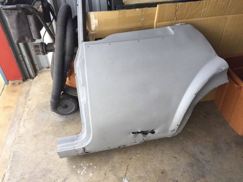

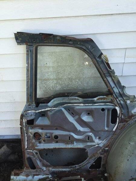

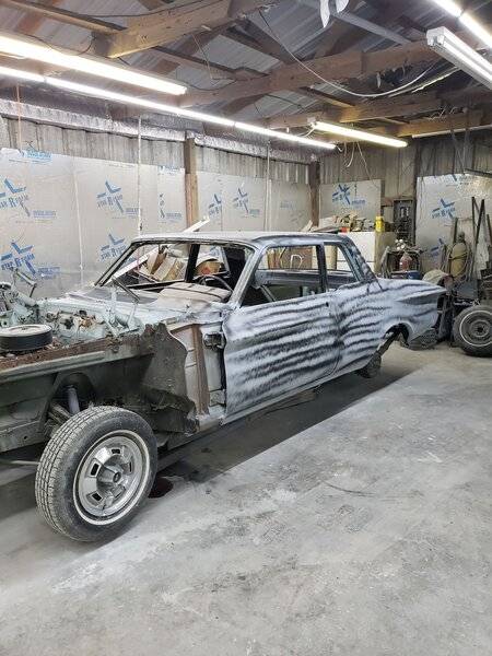

Agree, when mine was done I used the front doors from a 2 door since they are longer. I have a Savoy and was able to find those doors. However, I could not find the rear side window and quarter section from a Savoy so used a '62 Dart and the rear door skins from the 4 door car. No need to shorten the wheelbase.
