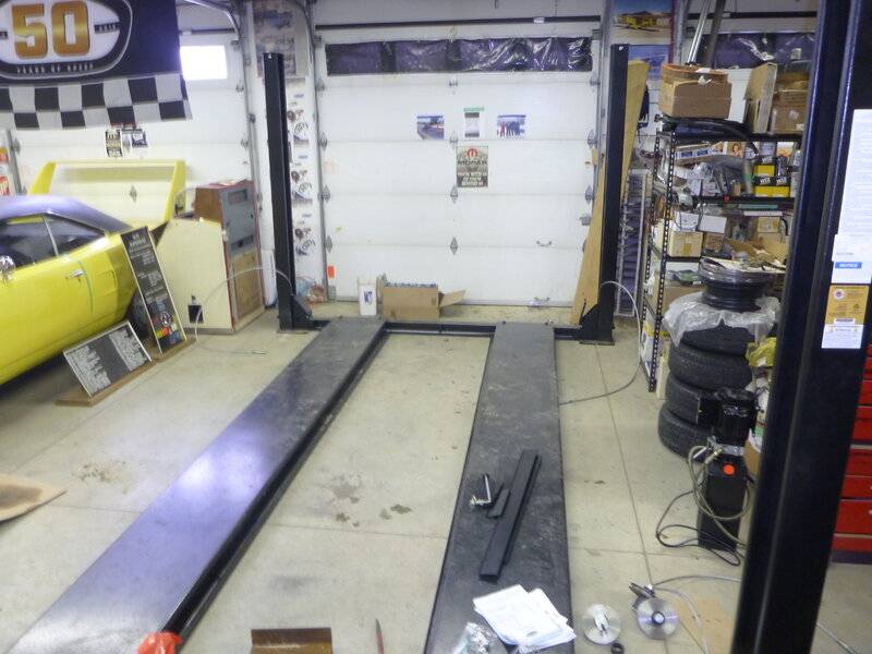

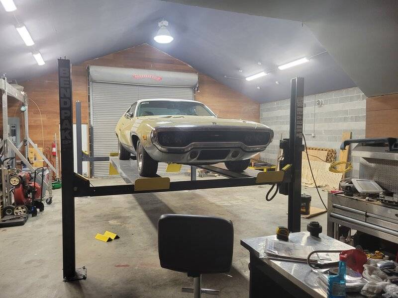

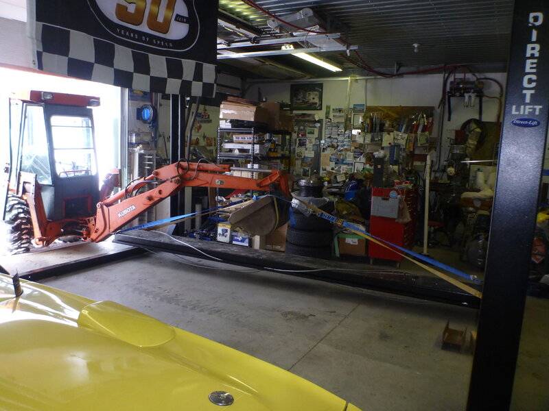

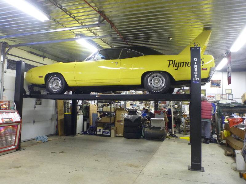

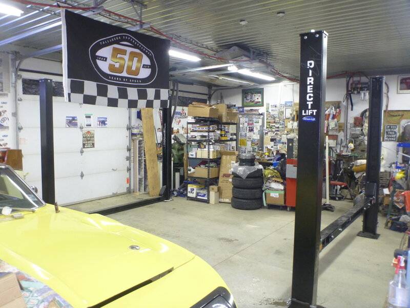

Mine's a 9000 as well, wide and long extended so my posts are outside the 9' door width.

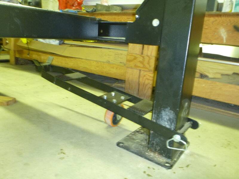

i'm going to check again, i would really like to have the rollersNote at Step 3.. 1. in brackets (if not bolting to the floor skip to item 3).

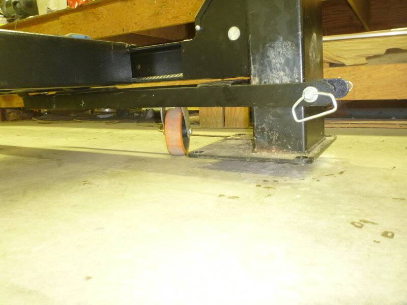

No need to bolt a 4 post to the floor unless you're using it for daily commercial service. Be kinda dumb to do so, if yours came with the lift rollers to move the lift around if you want to.

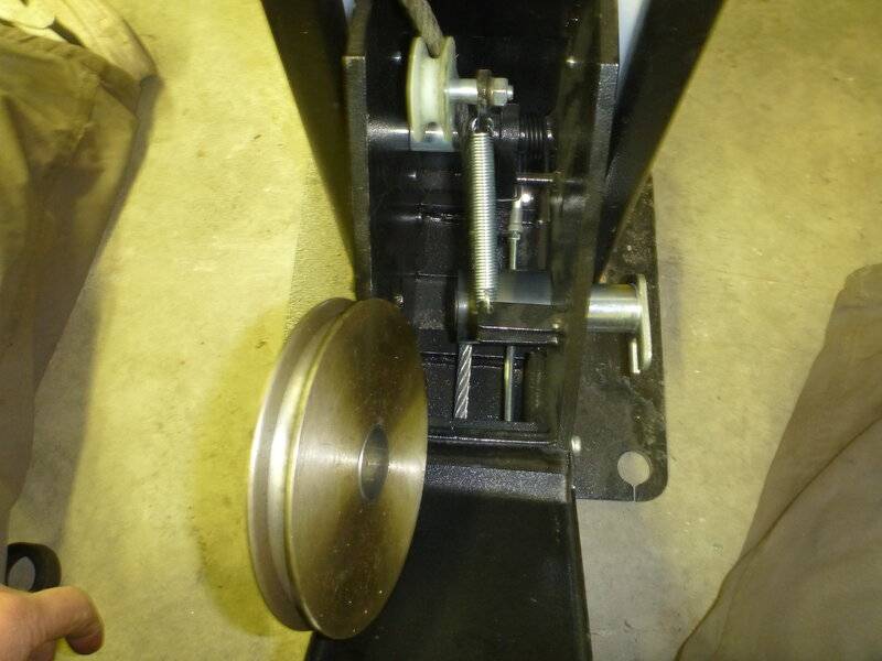

good idea !Don't forget to lube the wire ropes and pulleys.
I used the WD-40 Gel lube on the wires, and Bearing grease to lube the pins (sheeves?) of the pulleys.
