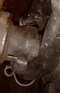

........so it looks like the fork is what's crooked....aka... slipped off the pivot in the bellhousing during installation.
I think what tends to happen is one side and retainer clip slides in too far on the fork and the other out as the release bearing twists around the retainer tube. As you apply the pedal, the fork twists on the pivot. Unfortunately it's always the top one. Probably need to pull the fork out to get both sides on at the same time.
Was this picture taken with someone pushing down the clutch pedal or not? At a glance, it "looks" like the throwout bearing has slipped off of one side of the clutch fork, so maybe the clutch for "holding tang" (looks like an old beer can punch) slipped off of the "pivot" on the bellhousing. You might have gotten lucky.
With nobody's foot on the clutch pedal, that throwout bearing should be back off of the pressure plate fingers...maybe 1/4" or so? At all times, those little "loop spring wire ears" on the throwout bearing should be clipped over both "tines" (fingers) of the clutch fork. It sort of looks like the fork "tine" that's behind the throwout bearing in your picture has slipped off. Since the throwout bearing is installed (transmission input shaft going through it), it can't get cocked sideways itself, so it looks like the fork is what's crooked....aka... slipped off the pivot in the bellhousing during installation.
No sir that was just at rest. My adjustments are all wonky because I was trying to get something. I'd imagine that's my problem. I took it all apart and made sure that I set that up properly. The bearing itself seems to be in good condition. I won't have it back together until tomorrow though. I'm doing this outside and up here in nepa it's getting quite cold.

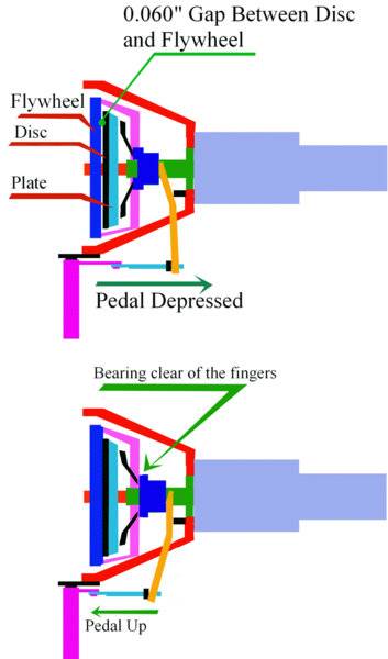

Look at the pictures that Daves69 posted. You need to accurately check 2 things.
1) With the clutch pedal up, that the face of the T/O bearing is not touching the fingers of the pressure plate.
2) With the clutch pedal pushed to the floor, that there is at least +- .060"clearance between the clutch disc and the flywheel.
If the clutch is adjusted correctly and you put it in gear, but the transmission output shaft is not turning, either the input shaft or main shaft is broken, NOT A LIKELY THING. You also would hear a commotion in the transmission.
My gut tells me the T/O bearing is too long and not allowing the clutch to compress the disc...
