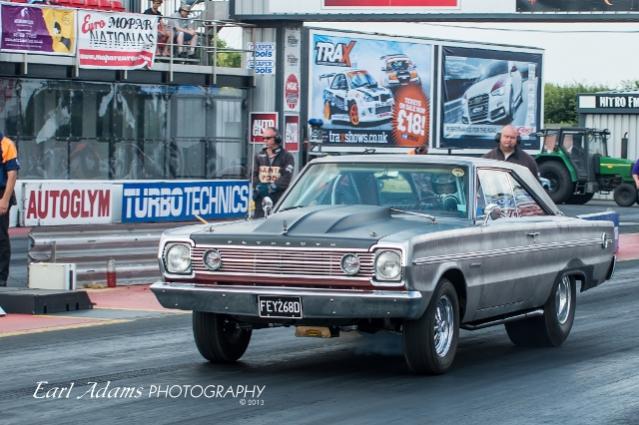

I have a '66 Belvedere with an Indy-headed 360 kicking out upwards of 425hp and my clutch just ain't man enough for the job :icon_sad:
I have an 18-spline Mopar gearbox & 10.5" pressure plate with a McLeod friction plate, stock flywheel.
It has 4.50 gears in an S&W 9" with Detroit locker, 31" x 16.5" Street ET's.

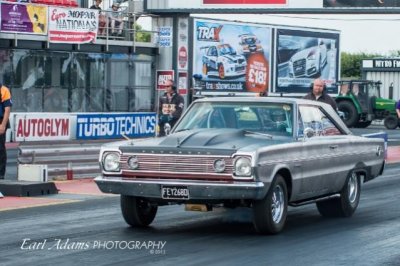

This setup was fine for moderate street use but my 1st outing to the dragstrip blew the clutch away on my 1st run, note the tell-tale puff of clutch smoke...
(..and due to having no rev-limiter the motor hit 7500, broke 5 spring retainers & bent one valve :oops:)

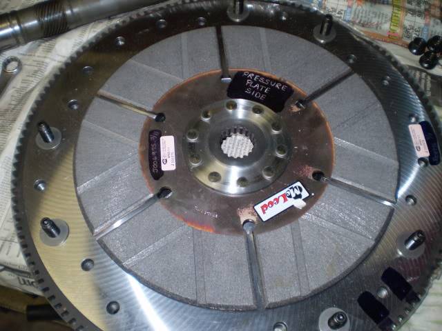

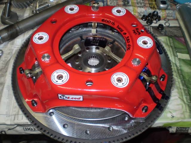

The 10000rpm stuff looks great, also the McLeod adjustable sounds a good idea- best of both worlds?
