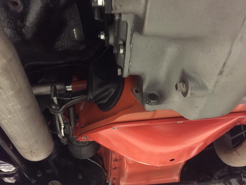

The welding of the hump, ball stud frame bracket and buddy seat brackets were very neat and even. Jamie took it upon himself to get a rattle can of FC7 and sprayed all the welded in pieces. They look like they were factory. I never would have been able to do that nice of a job which was one of my biggest reservations. I know that if the ball stud bracket is not located properly and square that the torque rod would give you continuous problems. The clutch goes in nice and smooth, even pressure, no hangups or snags.

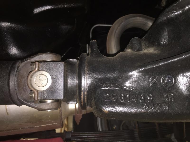

The other two things that Jamie did besides the conversion was change my power steering box to a Steer and Gear firm box because both my upper and lower seals were leaking and it was loosy goosy. It's like night and day. Much more responsive and better road feel. I was going to put in a Firm Feel, but the wait time was 2 months. The other thing was he change my u-joints. Apparently, Jamie thought the rear u-joint was original and never changed because of a wire across the joint that originals had. There was a lot of play in both of them anyhow so needed to be changed out. I would not want to lose the driveshaft while burning through the gears.

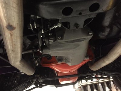

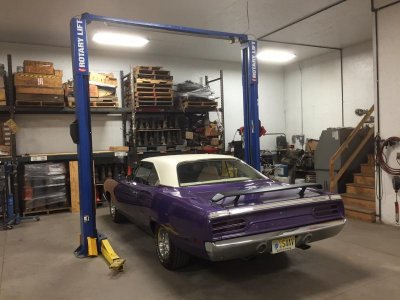

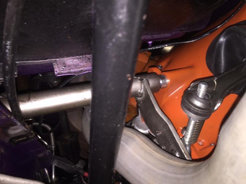

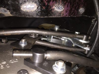

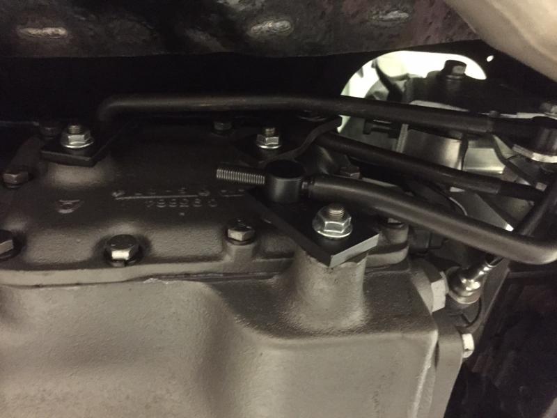

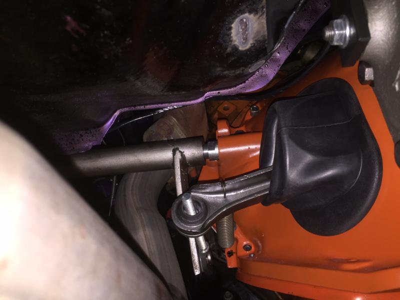

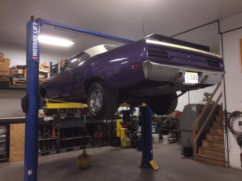

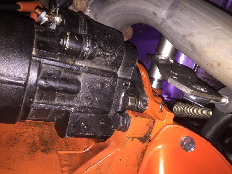

I will be listing for sale some of the parts i removed in a separate post. I have my 727, the console (switched to buddy seat), the console shifter, the automatic carpet and a 513 bell (Jamie had a pristine one that I decided to use). Here's some pics of the new setup.
