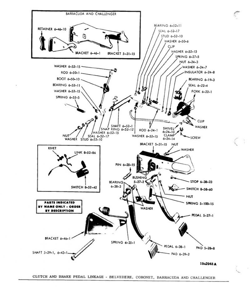

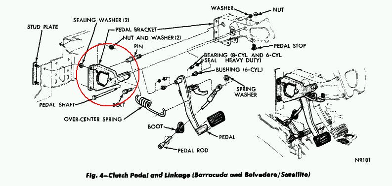

There's an additional bracket you'll need to hang the clutch pedal, and if you find that then you've got the whole thing so just change it all out at once. FWIW, that bracket is circled in the attachment taken from the 70 FSM and it shows all the parts involved. I also added the image from the parts manual, same thing though.
