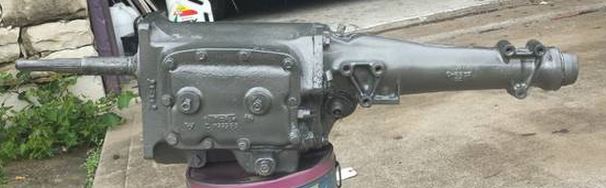

Waiting to hear back from this guy on a 4 speed that has already been rebuilt. Could anyone help ID it from this picture, like I said I am waiting to get the casting numbers from him before I go look at it. Thanks guys
Hi, Moparben here, I used to have a HEMI 4 speed as factory installed in my 69 GTX. The only thing I can tell you is if it is a HEMI trans it will be an 833 and have 18 splines on the input shaft. CALL Brewer's they should have something to tell you from the picture if anyone can.
It is a new process for B&E Bodied cars. The rattle can paint job is a red flag. I would check it over very carefully if it were me.

Thanks guys. I seen the paint and figured the same thing but I wanted to check to see if it would work for my application before I went to look at it. Needing a 4 speed for a 69 RR, from what I can tell from Brewers site is that it has a 70 and up B/E body tail shaft housing. I'll wait to hear from him and get the numbers.

I would pull the side cover off and take a look inside but it'll fit the 69 car no problem.....and yeah, the paint job is a red flag however, I know a guy that's good at rebuilding stuff but really sucks on his paint jobs lol.

23 spline B/E body application. Also look for a machined pad on the other side of the case. There should be a partial VIN on it and other smaller numbers with date codes. Keep in mind that new bearings, synchros and gaskets on junk gears doesn't mean rebuilt!
Well I spoke with him on the phone last night and he said he parts these cars out all the time and assures me that his friend did a full rebuild on the trans yet he has no clue as to where or why I want the numbers off of it. I also ask if I could pull the side plate on it an check the gears and he was very reluctant to say that I could. So as we suspected Im sure its a rattle can rebuild. What do you think its worth in a needs rebuilt stage?
