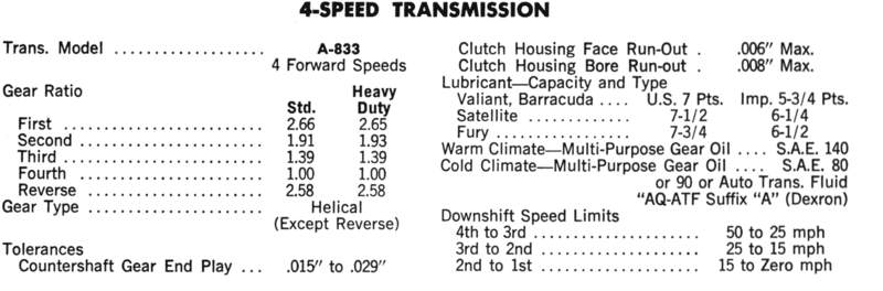

1. What weight gear lube is recommended?
2. What is the approximate capacity of an A833?
# 1. 90W gear lube.
# 2. 2.5-3 quarts. (my guess) I didn't look it up.
I'd say Jerry is right on. The "exact" viscosity of gear lube isn't critical....75W-80, 85W-90, etc should be ok. You can buy these "giant ketchup bottle pumps with hoses" at parts stores that allow you to pump gear lube up-hill (you'll need to do this) that work great. Buy 3 quarts & fill it through the side plug until it just drips out. Piece of cake
I had a slight gear clash 1st to 2nd (when cold), so I changed the fluid to the factory suggested 140. WOW!, got clash in all 4 gears. Went to Sta-Lube 85w90, slightly better but still had that 1 - 2 clash. Then I was advised to use Penzoil Synchromesh. Boy, what a difference. I highly recommend it.
P.S.
FSM calls for 7/8 of a gallon. I just put the whole gallon in it. Probably lost a good portion of that extra 1/8th trying to get the plug back in anyway.

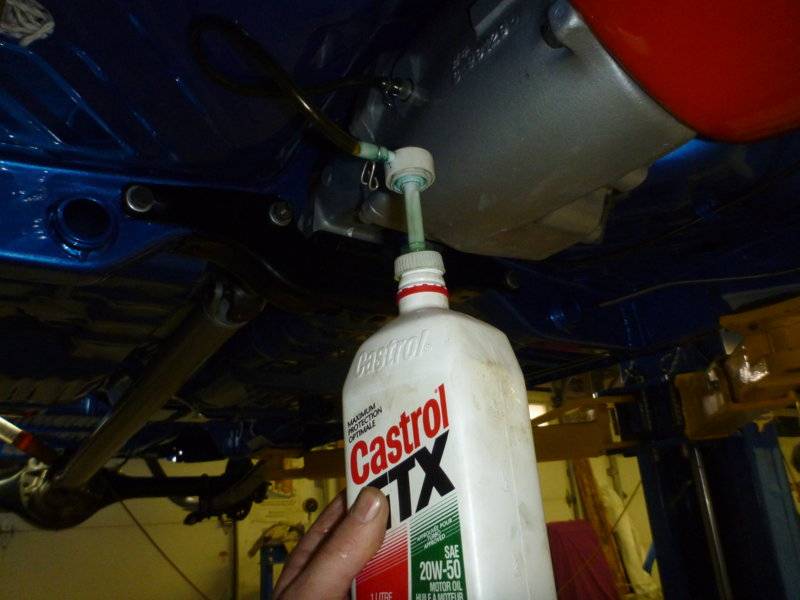

As wyrmrider pointed out.. remember that HYPOID gear oil belongs no where near a synchro transmission! Also note that SAE 140 oil = say 50W70... SAE 80 = 15W40. No different than straight weight Shell aircraft oil at 100 weight is the same as 20W50. Kinda like whiskey at 50% alcohol or 100 proof ! Considering that you can use SAE 140 or 80 OR Dexron Auto Trans fluid, I compromised and when I couldn't get any good trans lube in town used some 20W50 engine oil I had on hand. Transmission has NEVER shifted this smooth! No wonder the transmissions are quiet with 80W90 in them.. **** can't move. They are supposed to whine....
