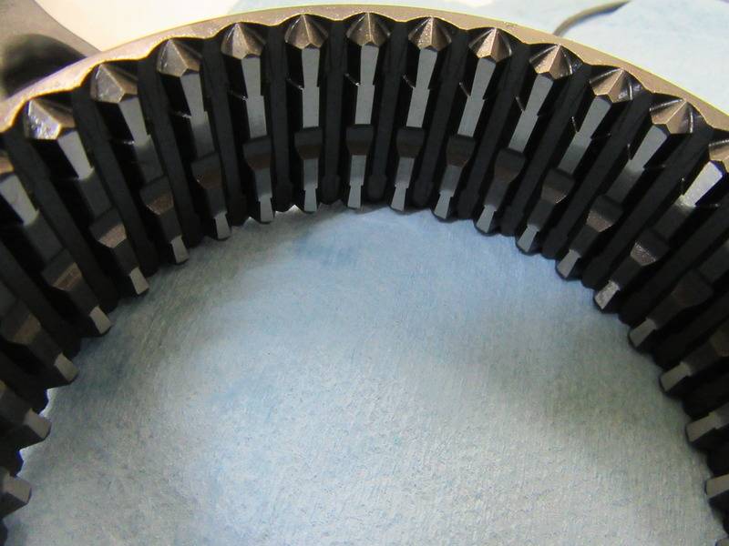

All of the above. Just have to tear in. Doubt it's shift stops on a Hurst shifter as they act on 2nd and 3rd gear - not 1st. If you have to replace the syncro sliders, you might want to consider torque-lock sliders. They help lock in the gear engagement teeth under acceleration and deceleration. A good idea if your gears look a little worn but still serviceable. I don't know anything about A833 insides but on a Toploader it's best to avoid reproduction gears from China unless absolutely necessary - thus torque-lock sliders can compensate for this to some degree. Here's a picture of what one looks like with the undercut/tapered splines.
