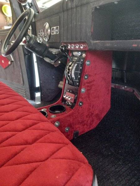

I'ts a cable type. Installed
in my latest custom build.
Zero complaints. Works
great. Very robust, with
many options on mounting
and shift patterns.
I can help you set this up.
It can be mounted directly
to the floor or on a console
they supply. If you decide
to go this route, I will give
you the console. I didn't
need it.
