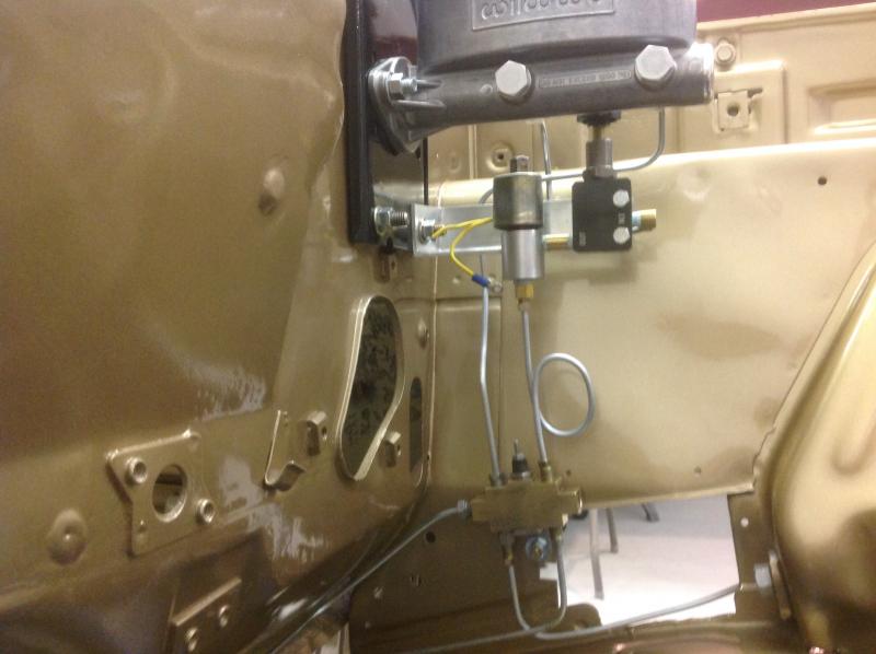

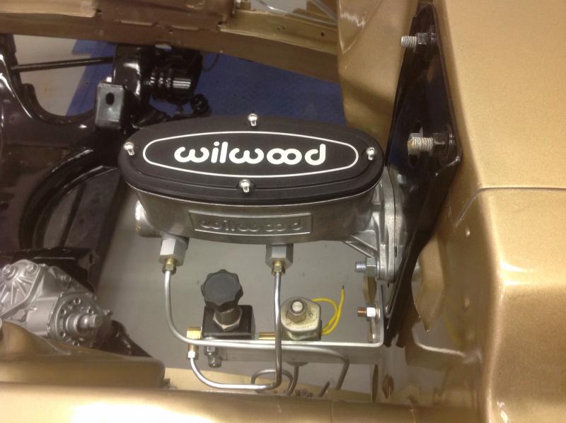

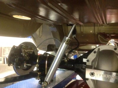

I used the rear disc brake conversion kit from right stuff on my Plymouth. It went together easily. My dana already had the green bearings so it was a simple bolt on. Bleeding the rear calipers was a bit of a hassle though, as the bleeders were not right at the top, so I had to slip them off, after I had most of the air out of them, tip them back and then open the bleeder. Up front I used a Willwood master cylinder with an adjustable valve. On my car the line lock had previously been put in the rear and that was new to me. I ended up leaving it there. image.jpgimage.jpgimage.jpgimage.jpgimage.jpgimage.jpgimage.jpg
