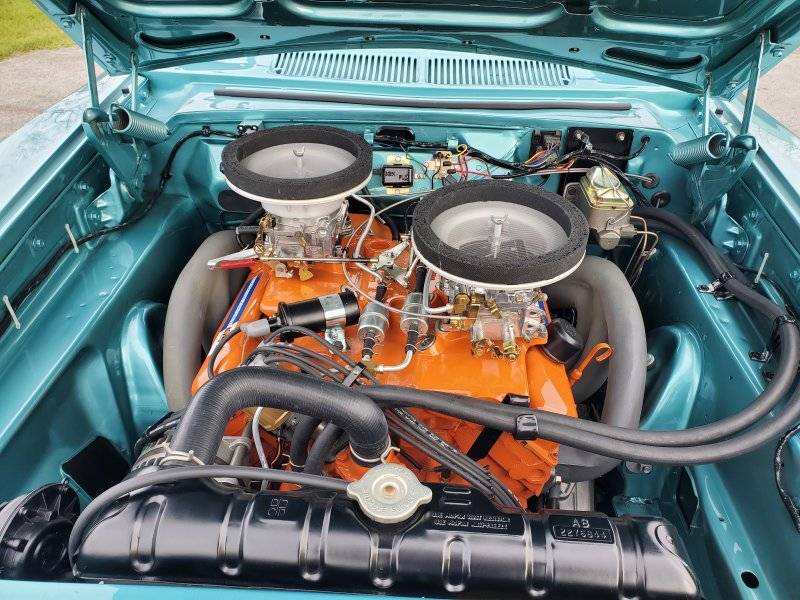

Mr S, not trying to sway your plans, but have you considered running headers instead ? I installed the MW exhaust manifolds, and they look, and work awesome, except for the heat factor. I can literally throw a raw chicken on mine, and eat it when I get to where I'm going. They really hold the heat for quite some time also, so the hood needs to come up upon arrival. I had mine coated, to avoid painting, so that may have something to do with it, along with the build specs ? For a driver, I would do mine differently again...

They DO Look Good, that's why I went with 'em !!!
Edit, after I posted,
This one's for You, Mark !!!
